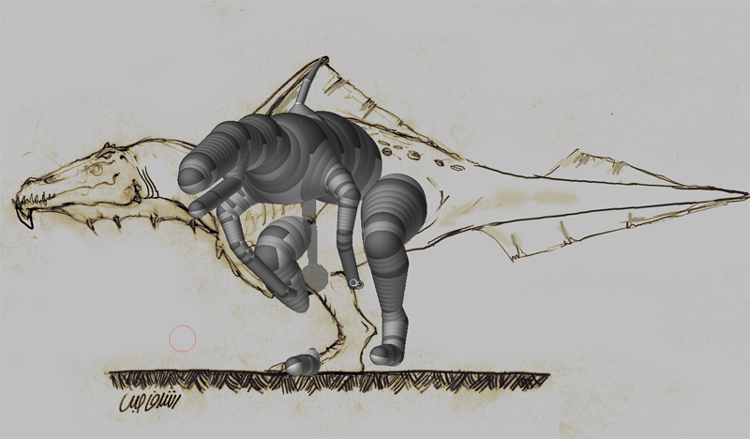

I just srarted playing around with this utility
my Q is
after placing the Image in layer1 for example
how can i move it backword so it will not intersect with my creature
if i try to move the creatre away , then it get smaller and i canāt allign it correctly
thanks
When you first place your model, before you enter edit mode, select move. The gyro should now be on the screen. Click and drag your cursor up or down anywhere outside the gyro and the model will move in or out.
that did the trick
thanks
as a SUG maybe it should be in the image plane settingā¦
Your welcome. Cool concept.
Hi ashaiad,
You can easily move your model forwards so that itās not clipped by the image. All you need to do is switch off the Edit button and then switch on Rotate, so that the Gyro is showing. Then click outside the Gyro and drag downwards to bring your model forwards. (You can rotate the model to check that it is far enough forward.) When you are done switch Edit back on and then set up and store your different image views.
