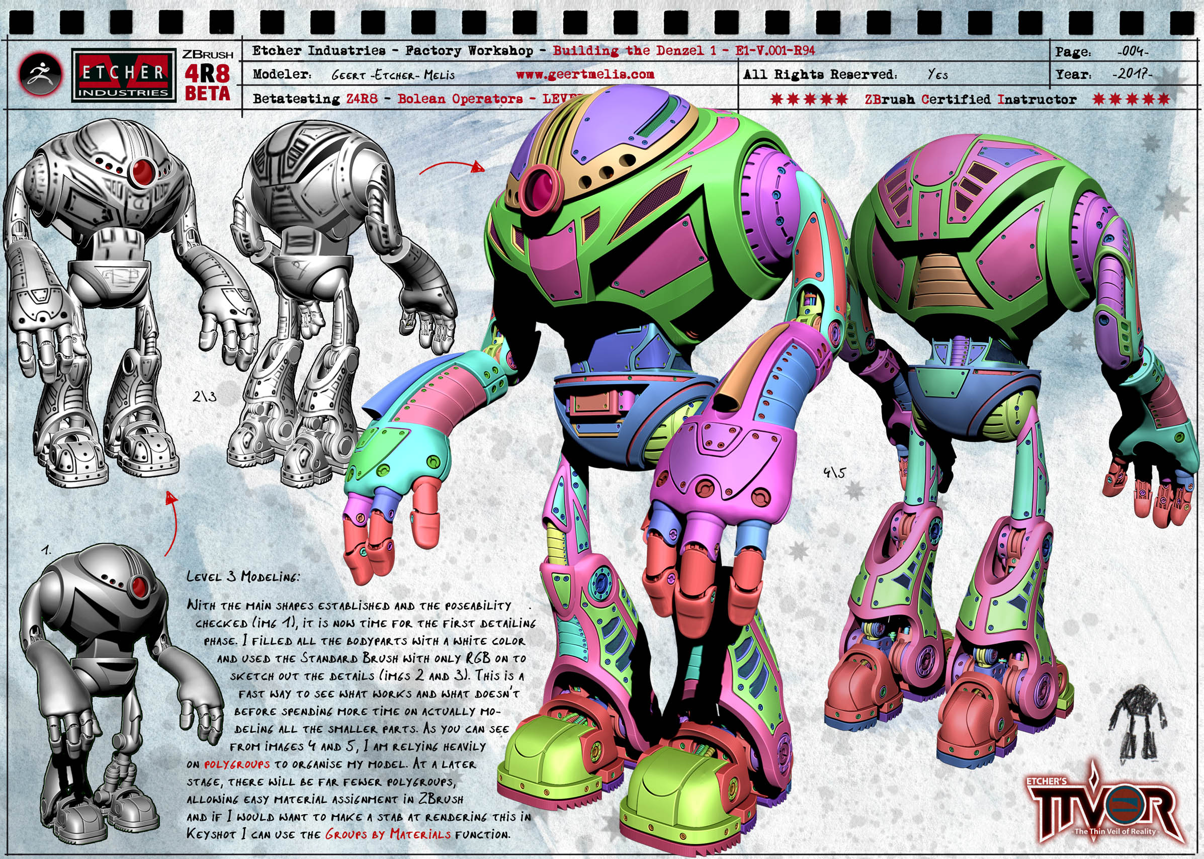

The Character:
For this test I modeled a “Thin Veil of Reality” character named “DENZEL”.
Built by Julius’s father to protect him, this E1-V.001-R94 model spends most of his time in the garden & the land surrounding Julius’s house (Riverlane 1). On several occasions he teams up with Julius and Ariana in their efforts to constrain the spread of the dark when the Veil opens.
The images below show him as he came out of the workshop, all shiny and new. Props, wear and tear will be added as soon as I get the chance to complete the other characters and depict them together in some storyline scenes.

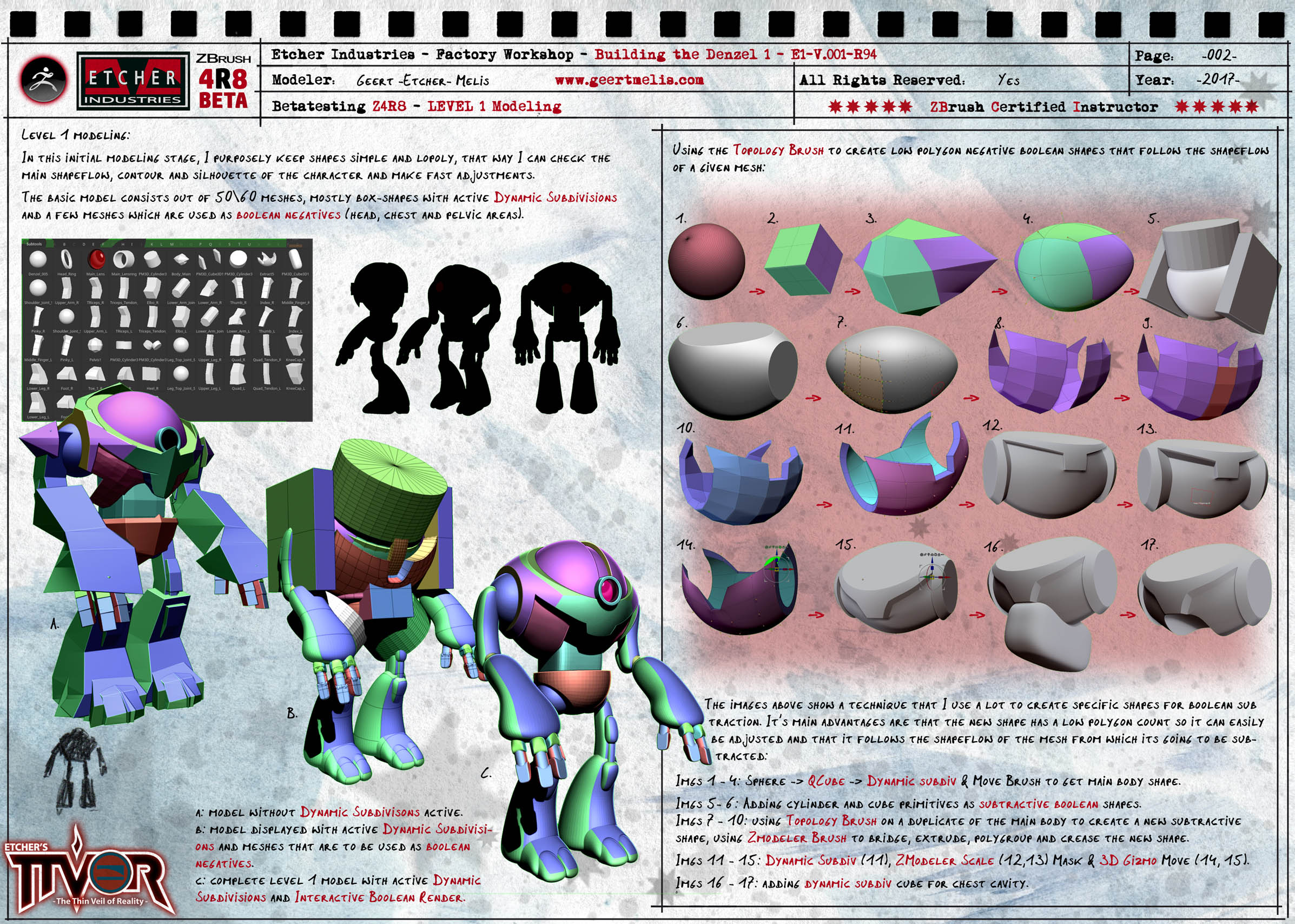

R8 New Features:
This R8 update provides us with new powerful features, they add to the toolbox and make ZBrush an even more luxurious concepting and creation tool.

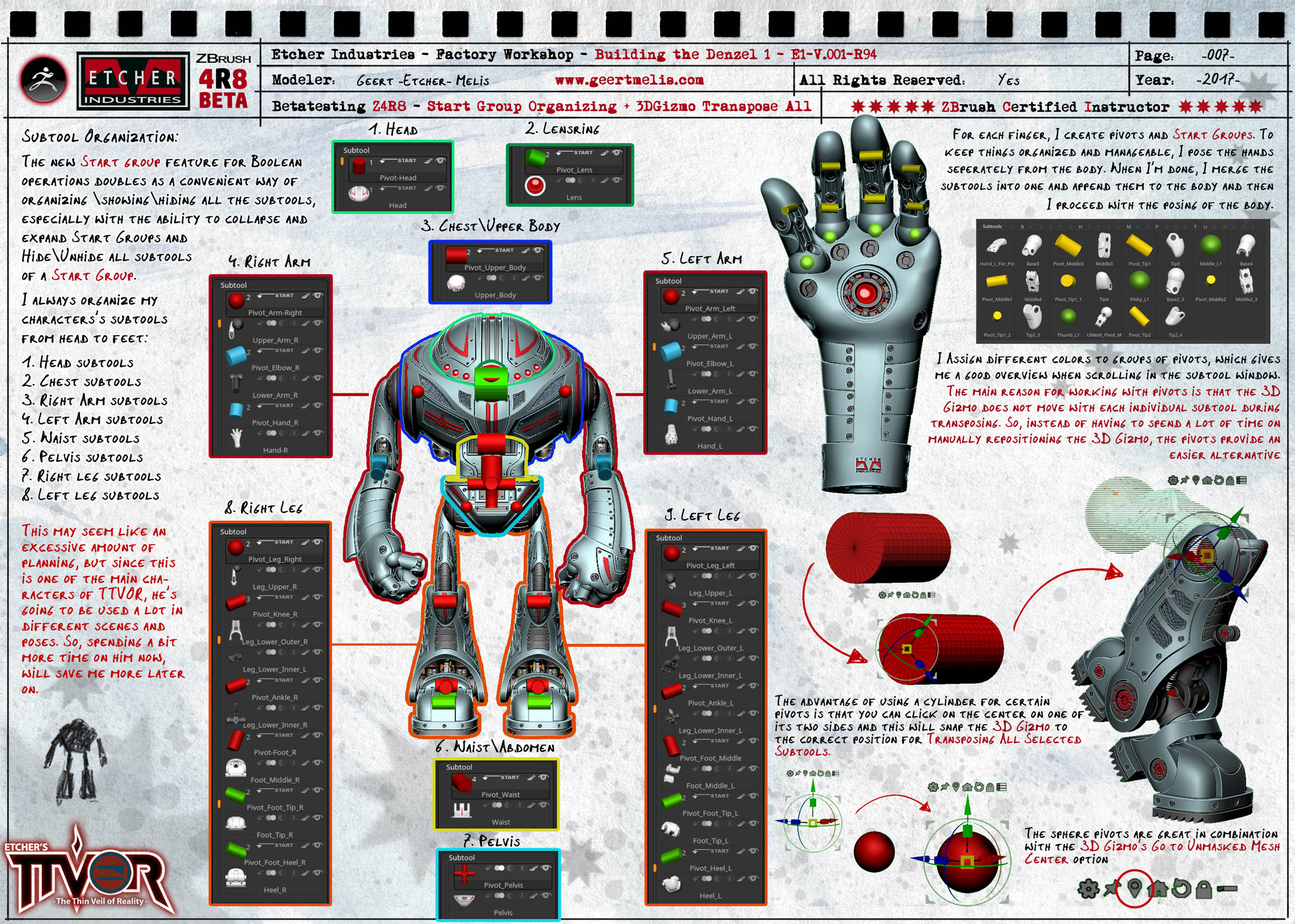

I put my main focus on working with the Boolean operators and the 3DGizmo/Transpose All Selected Subtools additions along with the new Transform Types (Deformers) and the 3D Text plug-in.
Following the image below, I posted my beta-notes which I made during testing/modeling.
The notes are not as in-depth as I would have liked them to be, but unfortunately time (or lack thereof) is always an issue. However, I do hope that you will find some use in them.
In an attempt to compensate for the lack of in-depth info, I marked essential new techniques and essential existing techniques red, hoping that this helps new ZBrushers when they want to look up additional info in the ZClassroom, Online Documentation or in the documentation that comes installed with ZBrush.

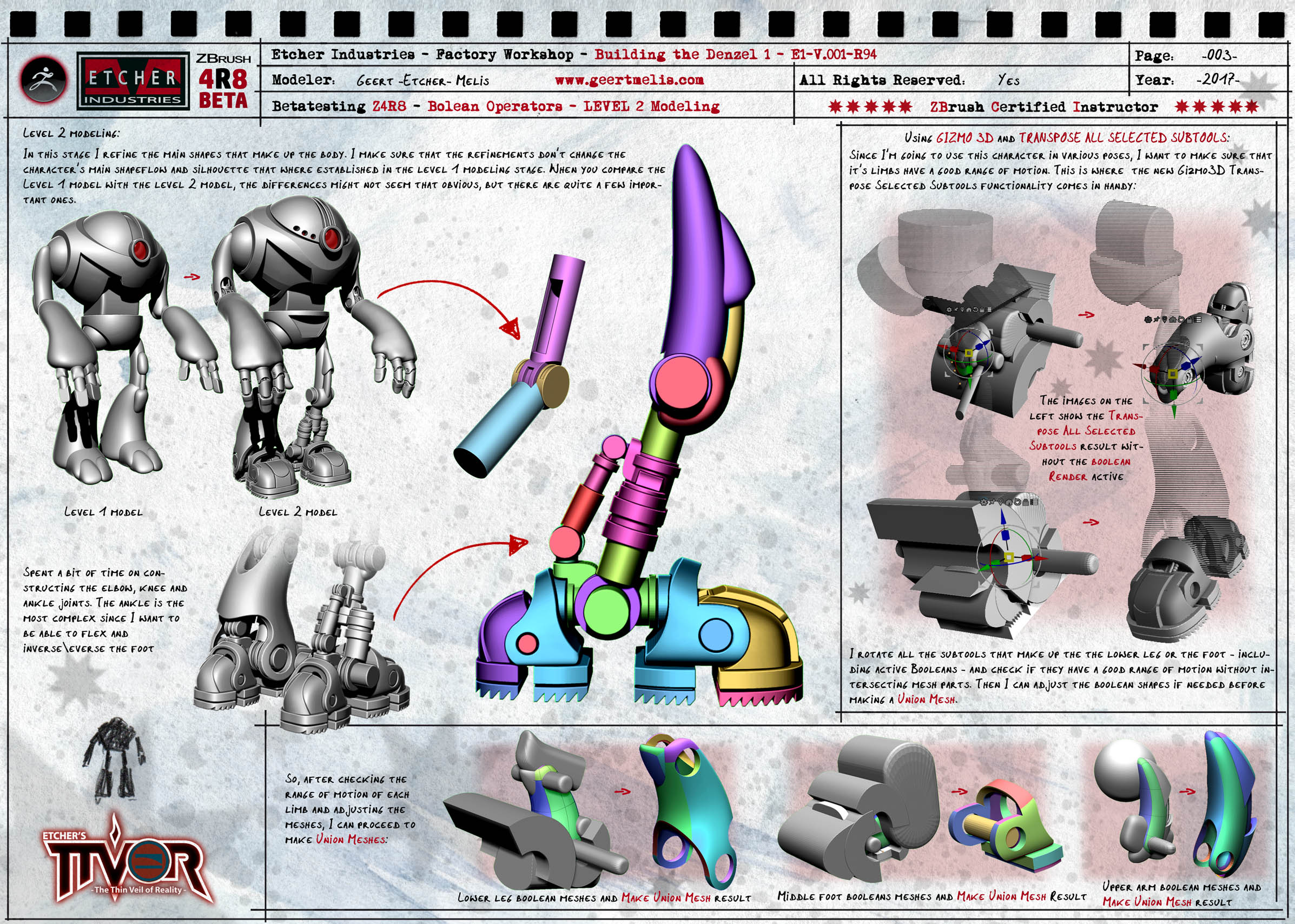

The vid below shows me testing the pivots & the new 3DGizmo/Transpose All Selected Subtools functionalities.

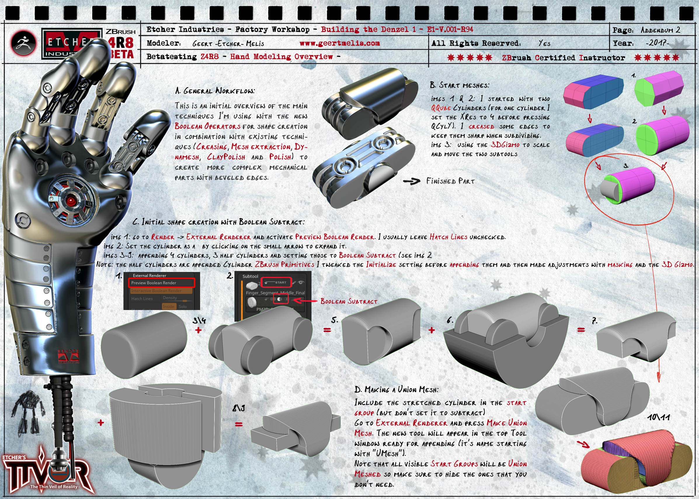

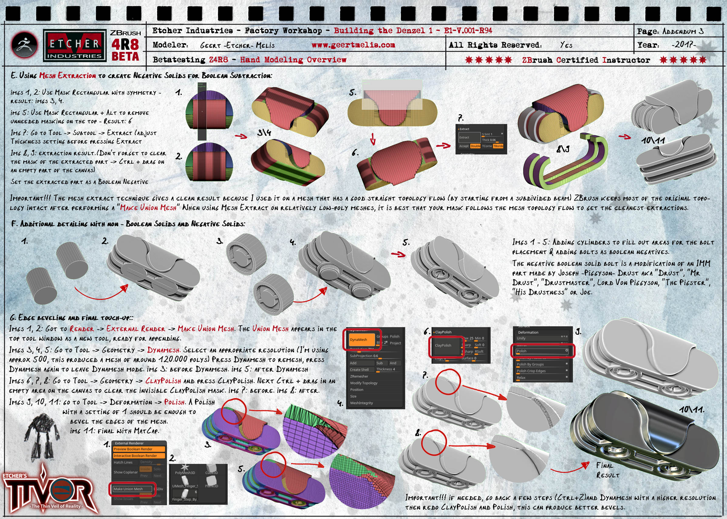

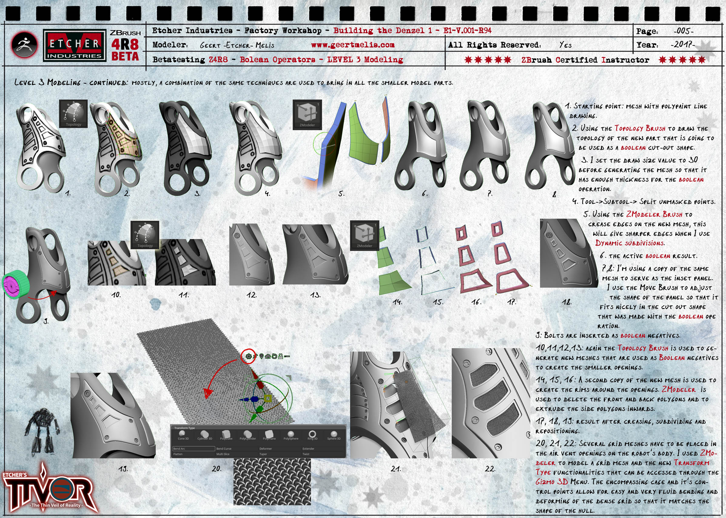

ADDENDUM:
The following addenda focus on the modeling of one small part but hopefully offer a more in depth look at the modeling techniques I mainly used for this guy.
The last step on page three deserves your extra attention since it focuses on applying bevels after boolean modeling.

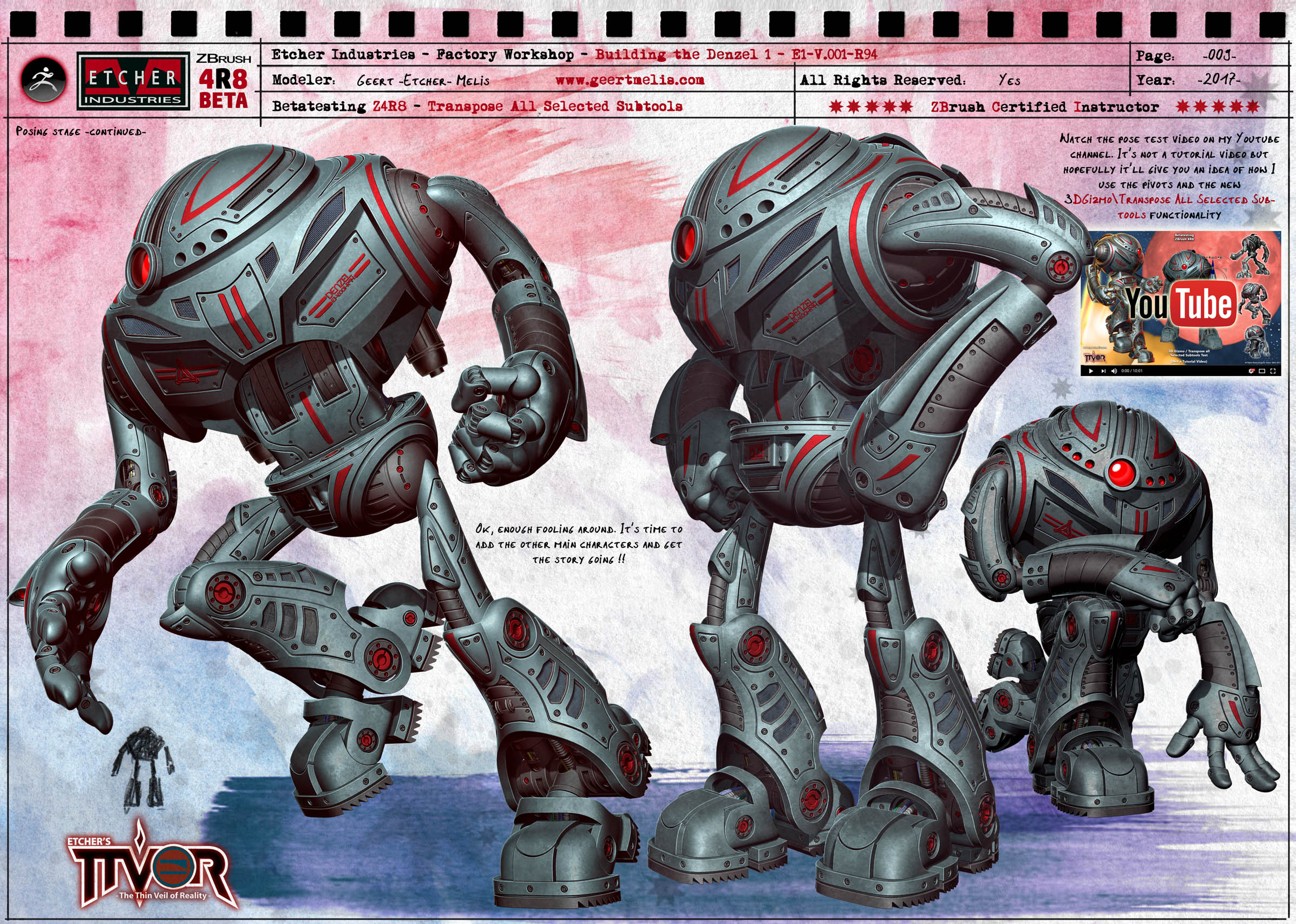

You’ve already given us so much in the way of tutorials, and yet I greedily ask for more - could you show or explain how you achieved that great illustrative quality in the rocket landing title picture when rendering out of Zbrush? Especially the yellow quasi-rim light on the arm - is it a special pass with a non-matcap material? I wish we could adjust lights in matcaps, but I doubt we can do that in 4r8…
Thanks a lot, Geert.
Your enthusiasm literally radiates from my monitor!
CWR63: Thanks so much for your nice comment :slight_smile: don’t bother to ask, the only issue is time… you made a correct observation: I used MatCaps for the base render and made additional passes to add extra lighting: I used the BasicMaterial and tweaked the ambient, diffuse and specular settings and set it as a backlight (I switched of all polypaint so the renders were in black and white) I imported it in Photoshop as a layer and added a Color Filter with the orange/yelowish color and set the layer to Screen. HTH!!:sunglasses:small_orange_diamond:+1:
Erik Heyninck: you are welcome Erik :slight_smile: it was great to be able to work on/with the new features - one can’t be anything but enthousiastic - let’s create!!! :sunglasses:small_orange_diamond:sunglasses:small_orange_diamond:+1:small_orange_diamond:+1:
Thanks, I appreciate the explanation - as time goes by I am increasingly more interested in non-photorealistic rendering techniques. Excellent technique and results! :stuck_out_tongue:
