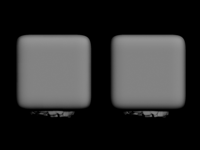

Update: From what I’ve read at ZBC, there has been a “break” as people refer to it, from ZB2 and Max 8 to ZB3 and Max 9 - 2008 and it’s connection with MR and the Quick Codes. I’ve run some test using ZB2 and Max 9 32 with correct results (see below). So I can guess that the “break” has been with ZB3 and not Max 9.
First Image: ZB2 to Max 9 32 Displacement Test (cube on left is High res obj, cube on right is low res displacement mapped mesh). Notice no bloating.
Second Image: ZB 2 and Max 8.
Looks the same to me, off to try ZB 3 and Max 9 to compare.

[attach=75943]MR-Dis-Test-ZB2-to-Max-8.jpg[/attach]

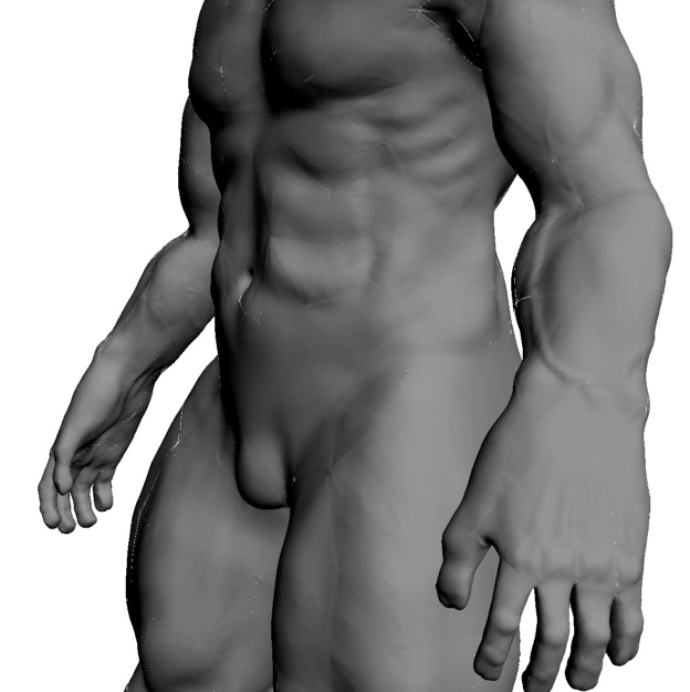

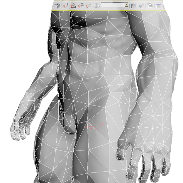

Following the tutorial, but making your suggested changes, Scratchy, I was able to get a somewhat working displacement map to render, though, I’m still having a problem with “cracks” in the rendered mesh.
I’ve attached two images, one of the render with the displace and the one of the wireframe superimposed over said render. Is this something that anyone has expirianced before with displacements in Max? Is there a “quick fix” to this problem or something I’m forgetting to do?

Edge Length 1.0
Max. Displace 2.0
Displacement Length 1.0
Extrusion Strength 1.5
