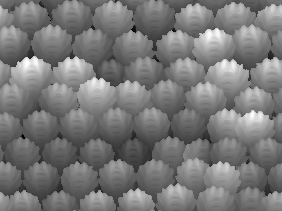

Here is my first attempt at seamless alpha creation using the aurick technique!
Enjoy
