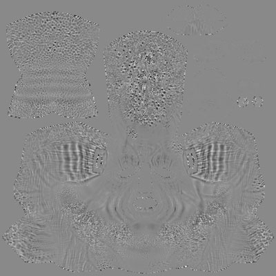

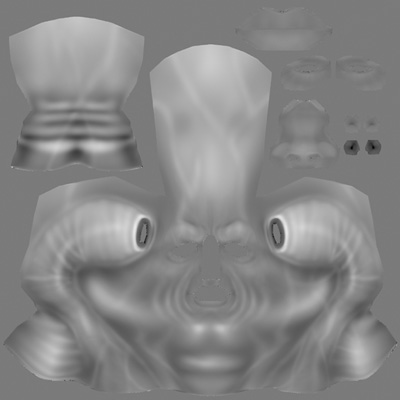

hi all! in my experimets with the xsi-zbrush worklow (but i think is good for any software-zbrush workflow) i tried this tecnique to create nice result in create bump and displacement mapping; here it is:
first i create the basic displace in zbrush at a level 5-6 of subdivion (itdepends on base geometry); after i go to higher subdivision level (6-7 for example) and i detailed it with projection master with my own alphas; finally i delete previous subdivided level so i have only a differnce between 6 and 7; i create another displace map for these two level and i obtein only the details added with the projection master; hope u understand it becouse my english is not so good yet.
here are the two maps as an exemple (u can find the WIP here: http://www.zbrushcentral.com/zbc/showthread.php?t=25397)
DISPLACEMENT MAP:
