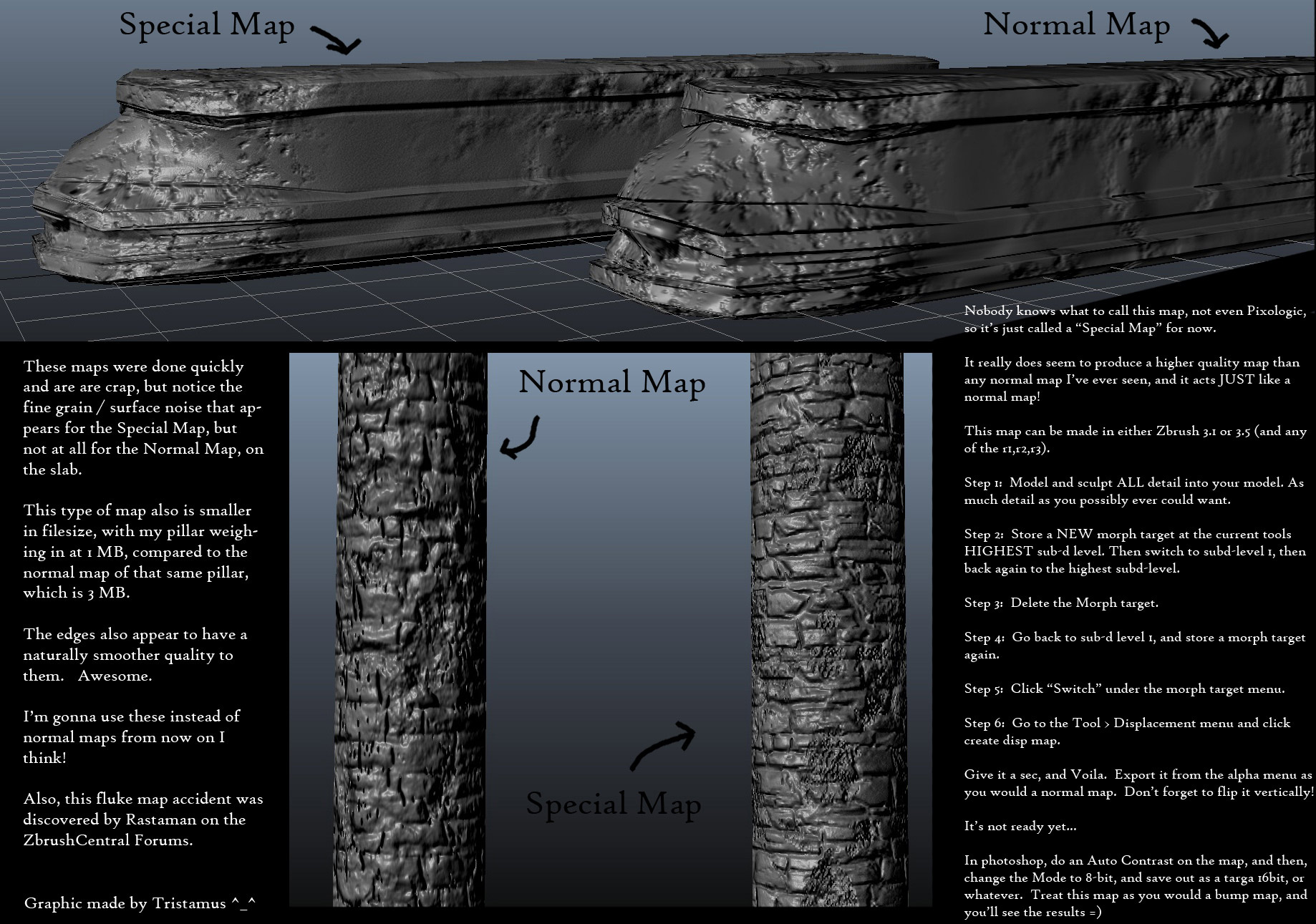

I have made a graphic for you and everyone here on the differences and perks of using a map like this. I hope you all can benefit from this!!
If anything in the graphic is wrong, just let me know…
-Tristamus

umm isn’t this “special map” just a displacement map?
Umm I dunno, that’s not what people here are treating it as. The thread title is “ALTERNATIVE” to displacement and normal maps, so I figured it isn’t a displacement or normal map. Created through the Disp Menu in Zbrush, yet, not appropriately. Almost as if it is a glitch. Pixologic didn’t know what it was.
Do you?
thank you for the graphic tristamus
No problem man!!
