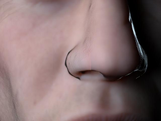

Hi, This looks like a good place to ask people about this.
I can’t figure out why my bump map creates these black lines in some creases of the face and wondered if anybody here has had similar issues and knows a fix? I’ve tried mapping 16 and 32 bit displacement maps and normal maps into Vrays SSS2 bump channel but can’t get a result.

RHudson: I never had this kind of weird render, but I guess you are using a normal map? try to not use it and redo a render to see if it does it again. and don’t use 32 bit with Vray, do not work for the displacement excepted if you used it in exr format. I use 16 bit, it does the job and weight less.

Big guns, I’m using a normal map in tangent space and it’s fine when I delete it.
I ended up reducing the contrast of the map where the dodgy shading happens. It’s not a proper fix but looks better than it was. Actually I get quite alot of unwanted shading from the normal in general so used a highpass filter to extract the tighter details and it looks to be ok for now.
Thanks anyway and your results are fantastic btw. Also, I’m trying to get better back scatter control using a blended material and wondered if you used a map for this or had any tips?
