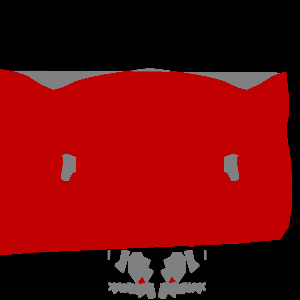

3am_ have you done a Uv Check for your model?
I opened you model in Zbrush 3.1 then did a Uv Check.
I have converted the resulting .psd to .jpg for reduced file size.
The resulting texture shows a lot of over laping Uv’s as the red indicates.
I suggest using Blender to unwrap the model the Cannedmushroom way.
Remember to make the unwrap Uv’s slightly smaller in scale so they do not reach outside the base region.
Alright, I’ll give that a shot. I just got the video downloaded to see how he does it. I’ve not used blender before so I’ll have to read up a bit on that too. All of this seems pretty complicated right now for setting stuff up! :stuck_out_tongue:
