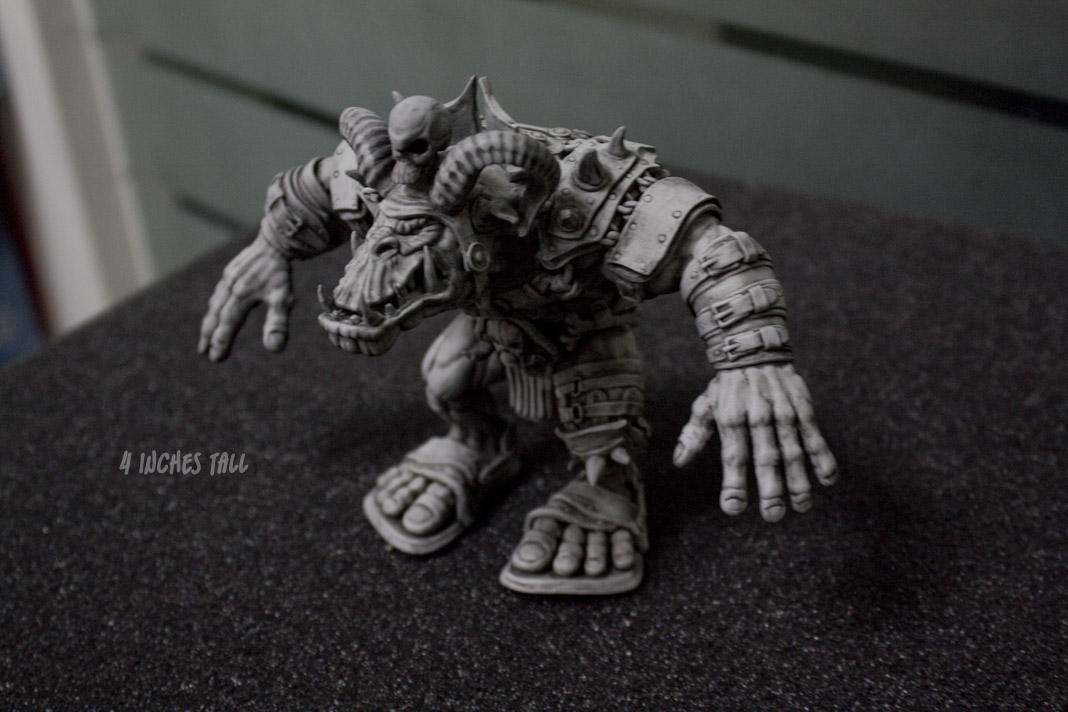

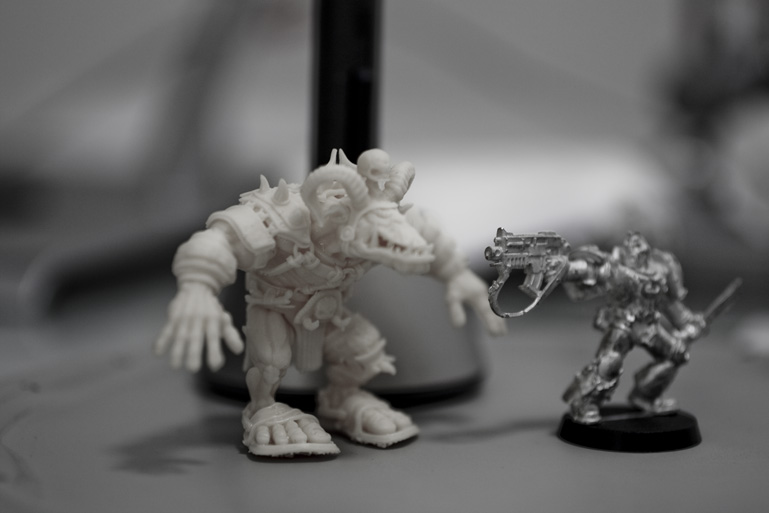

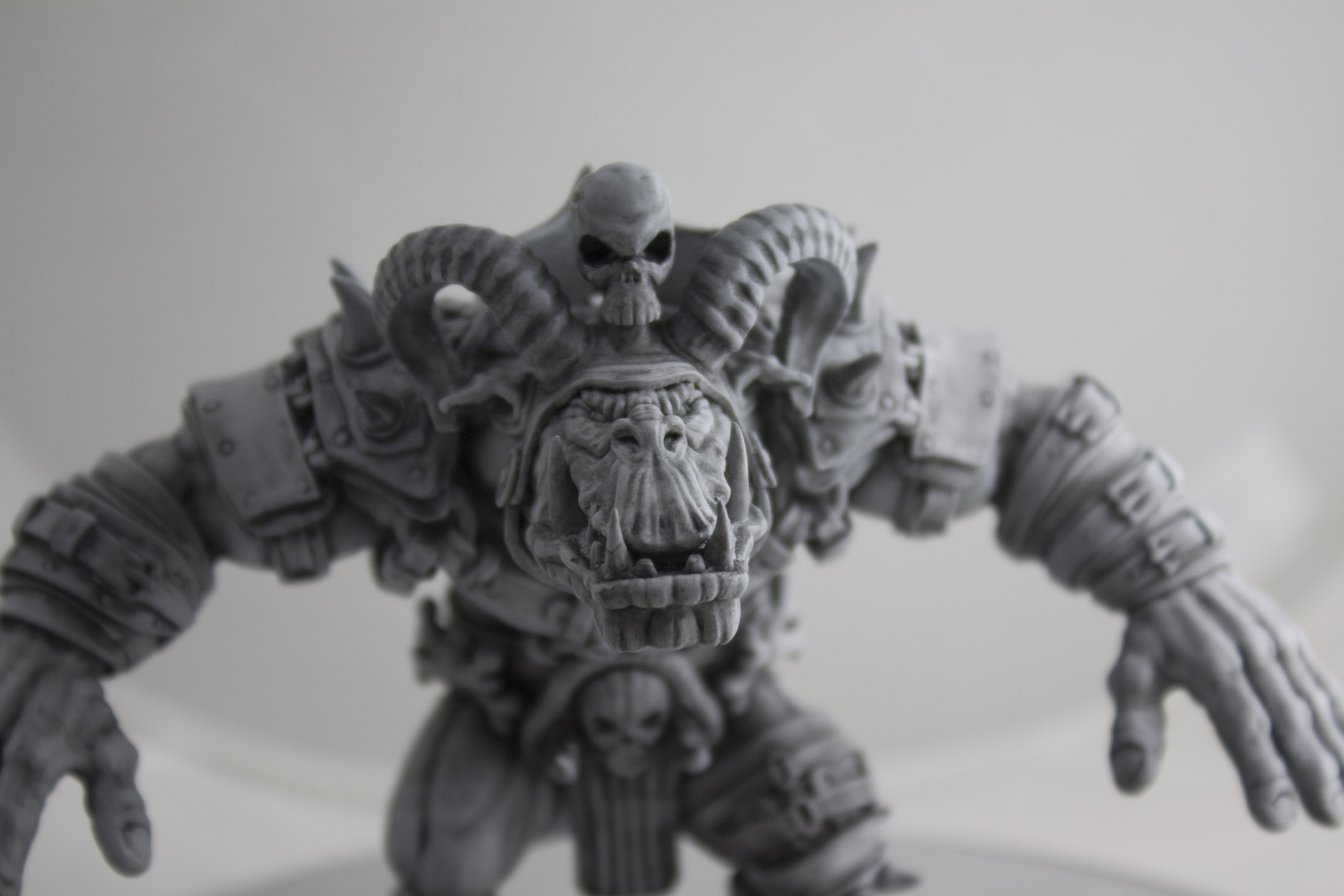

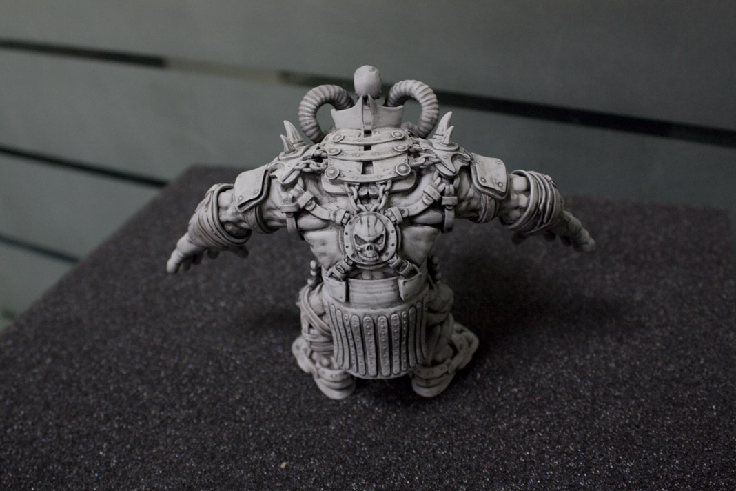

Here’s one I did for ZBC’er jbuck (Joshua Buck). He was nice and gave me this WarGaming Orc so I could perfect printing models at 32mm (we’re almost there!). But I did a bigger one for him as a gift for helping me out. This one is four inches tall. Although normally it would have cost $189-ish to print it because it was so fat (more expensive than some 10 inch tall models!). Paints like this “AO Bake” are free if you want it. I’m not even sure I charge for full color paints at the moment :laughing:. I just type a random low price in really~
[attach=137058]plains_Orc_front_01.jpg[/attach]
[[attach=137055]jbuck_1.jpg[/attach]]jbuck_1.jpg
[[attach=137056]jbuck_2.jpg[/attach]]jbuck_2.jpg
[[attach=137057]jbuck_3.jpg[/attach]]jbuck_3.jpg
Gimme one more week to finish that other freebie. I’m making 4 copies, printing it flexible-ish and adding articulation.

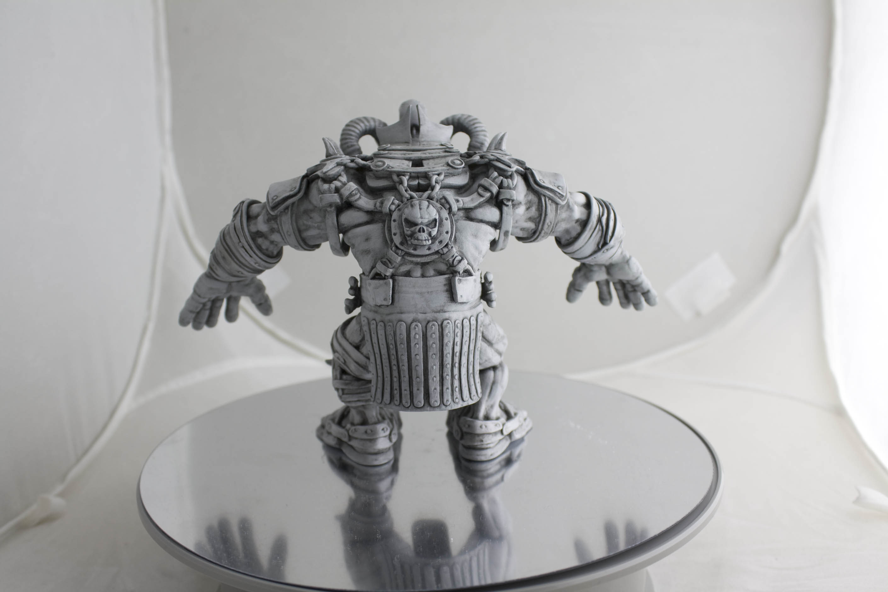

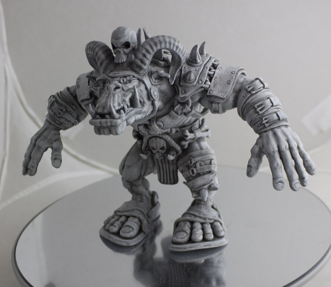

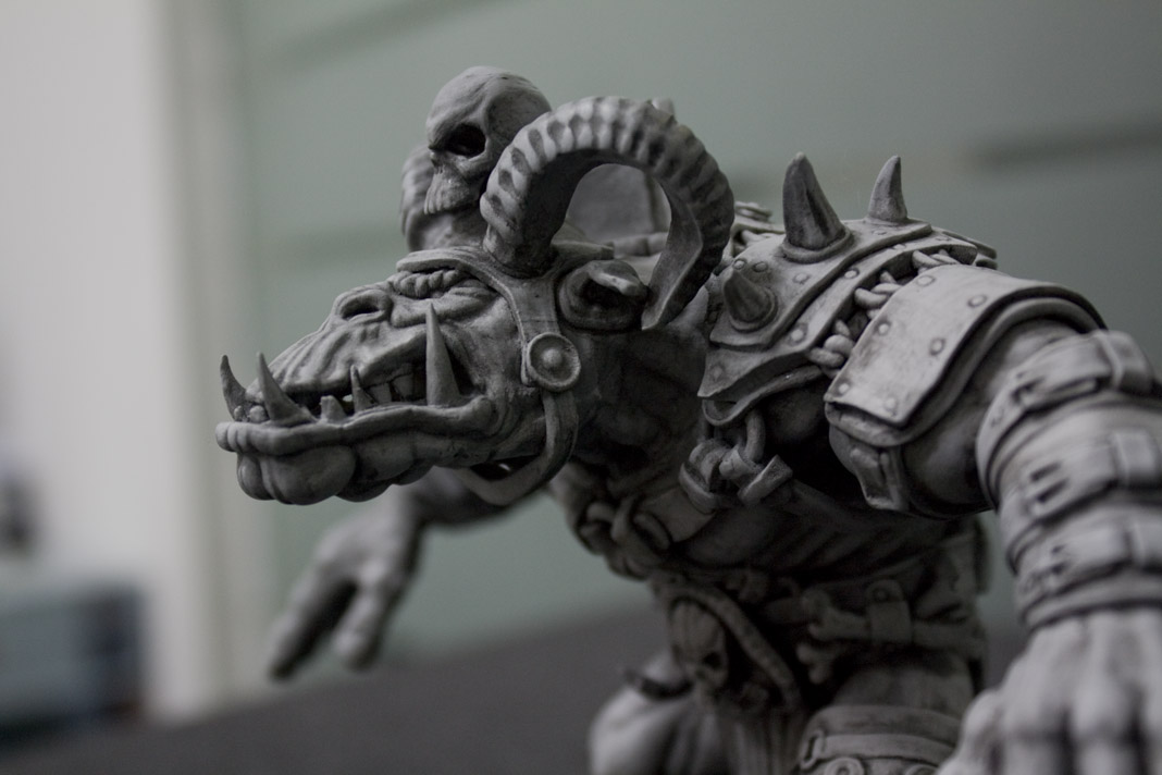

better pictures cause i used tripod. :stuck_out_tongue: i kept the resolution at like 3000 pixels in the attachments below so you can see that I’ve basically destroyed rapid prototyping stairstepping now.

you’re doing great work with those prints Desmoda! :+1: :sunglasses:
this is a great update!
i’m curious though as to the inflation on the belt buckles on the arm, they seem to have doubled in size, the metal parts not the leather. i’m guessing they were separate subtools or something, could you explain why this happened?

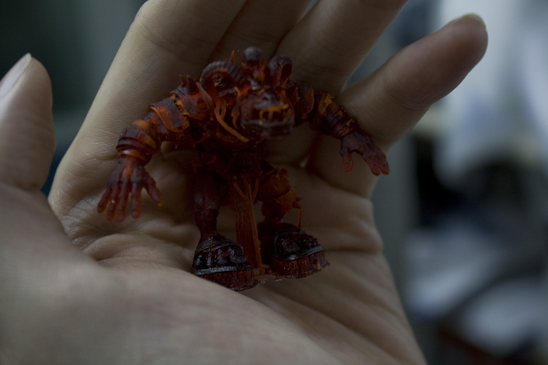

Good eyes! I printed this at 50mm and the belt buckles and chains on armor plates all turned out like fishing wire. It was all there, but way too thin. So, to make it look better we inflated the belt buckles and chains for the 50mm. And for the sake of not having to fix the file for printing again, we just printed the inflated version for the large size as well. (attached bad print) when i have a good 32mm-50mm print. I’ll primer it and show you guys.

how long does this kind of ao finish take you?
AO finish like that takes about 15-30 minutes. In toy painting, it’s called ‘washing.’ So it’s not a true AO bake. Washing is the technique that you cover the entire model in a diluted ink, and then use a cloth to wipe it off before it dries. All the recessed areas will be darker making the model really pop. Sometimes washing is better than a true AO Bake, especially on wargaming figures such as this. I used a lacquer basecoat so that Joshua can do a full paint on top of it later if he wants to :):+1:.
  To paint a true AO Bake, you'd have to use an enamel based paint (because it dries really slow) and then dab a few drops of paint in the recess area.  Before the paint starts to dry, use a brush to sweep out the ink into a nice gradient.  It's a lot cleaner finish, but it takes more time.  It's possible to do this with a wash as well but you'd have to pick a very subtle wash color and do a very good job wiping up the slop.
Another trick is that you can go out and buy some cheapo Artist’s Oils like Windsor & Newton. Dillute it down with turpentine. And you got one of the best AO Bake oils available =P. Very smooth finish. But will tint/alter your base color slightly. Which in itself is another trick that some artists use on skintones to give skin that two-tone SSS/flushed look.

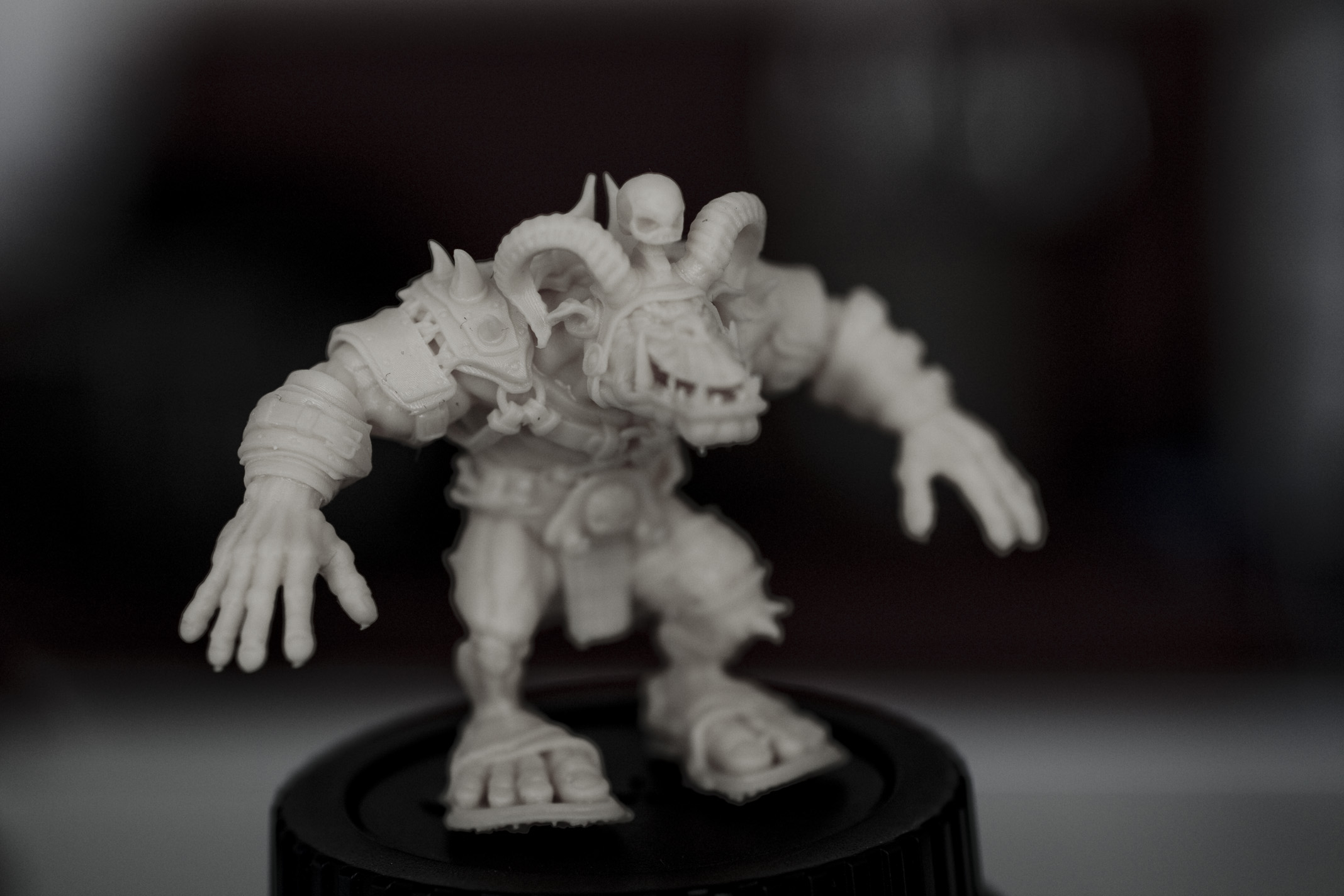

  Here's a picture of unpainted ownage print to show the difference washing/AO Baking can make.

the 50mm is looking better and better. this is the model straight out of print with no sanding or primer or nuttin. now imagine if i get my artists to work on it a little bit. i’ve attached the high rez below so you can zoom in and see the stairstepping. but remember that the model is about the same size as your wacom stylus holder. and the stairstepping is barely visible. can probably make it better and go down to 15 micron but its not worth the cost because i can have artists do the same work in 10 minutes for like $5.
