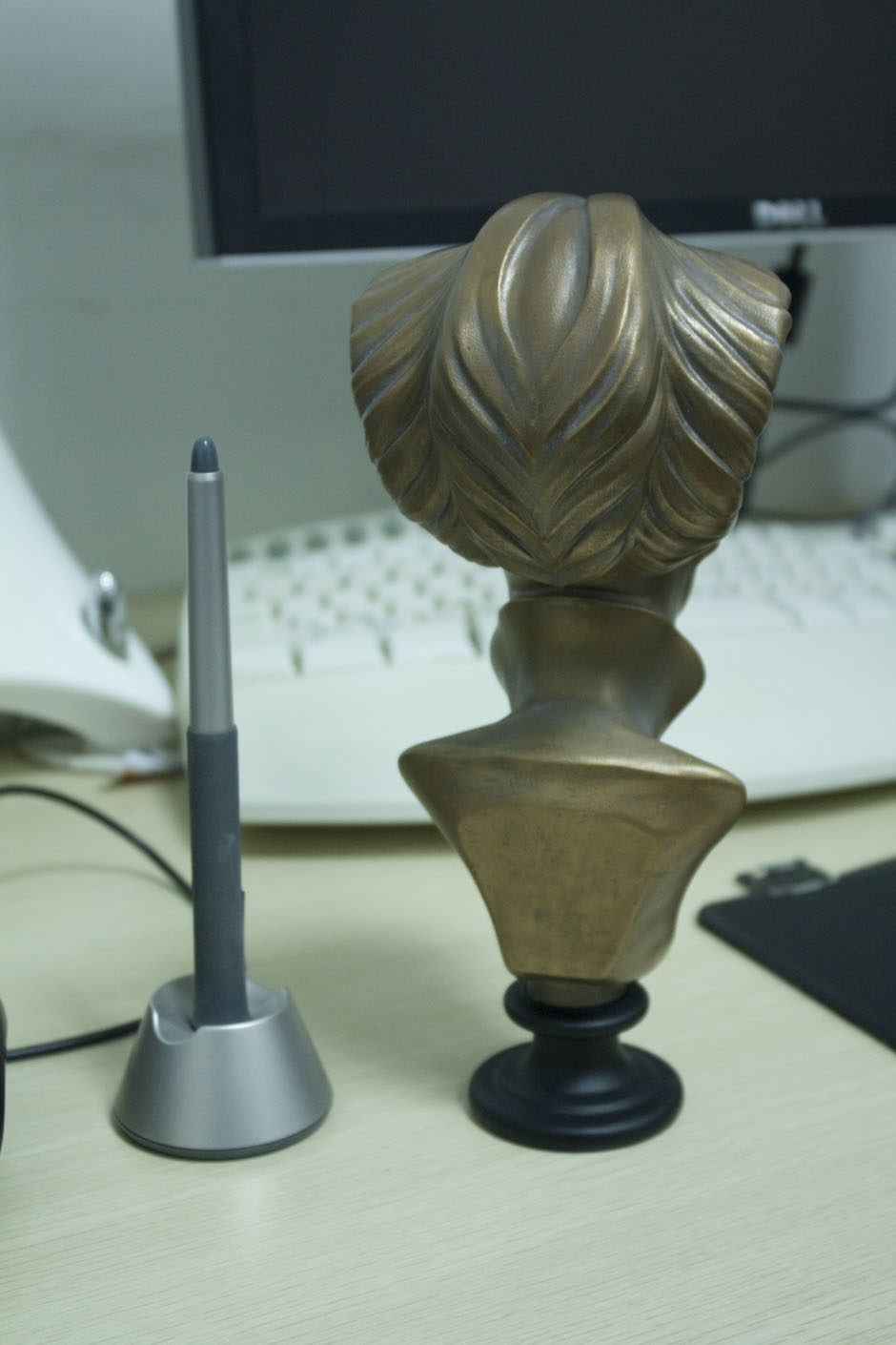

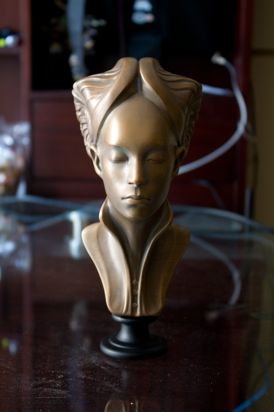

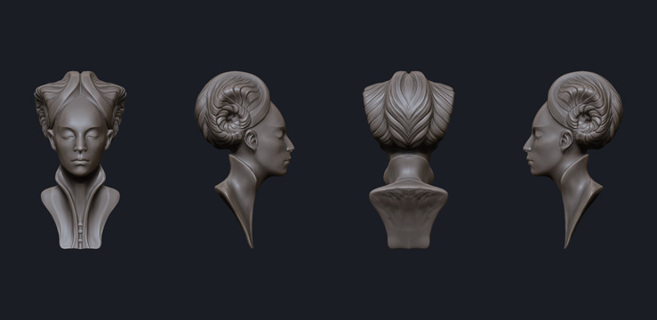

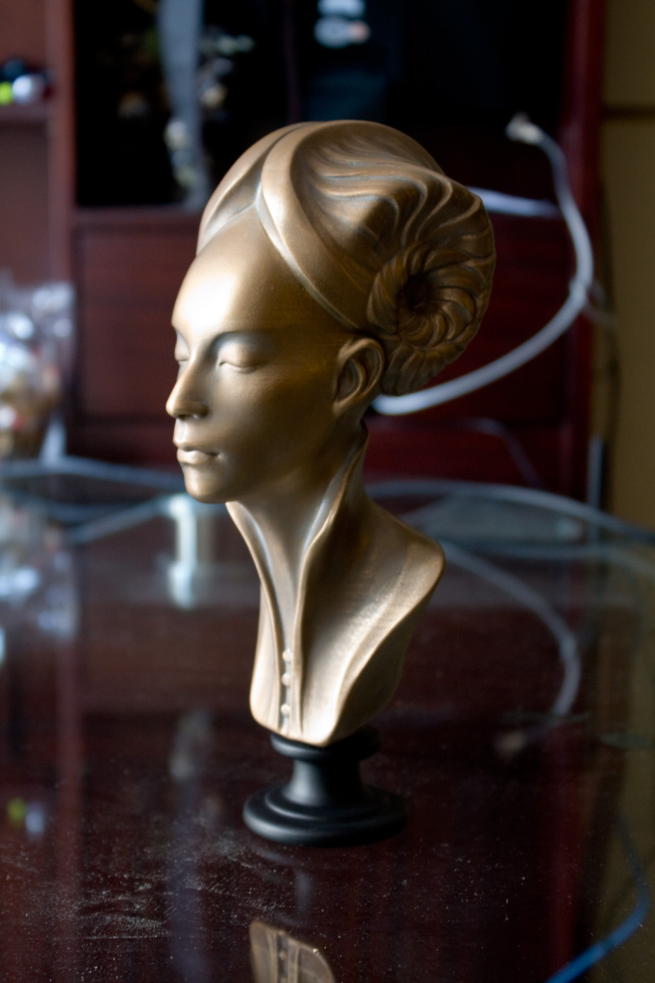

Second, finished Magda’s sculpt + paint unless she tells me she wants to change something. Haha… this was a easy one in my book~ Pst… I love easy ones. But I also like challenging ones. hrm =/
[[attach=121241]ref_sm.jpg[/attach]]ref_sm.jpg
[[attach=121393]lighting_fixed1.jpg[/attach]]lighting_fixed1.jpg
[[attach=121394]lighting_fixed2.jpg[/attach]]lighting_fixed2.jpg
Third… I updated the order system and unpainted models are now $279. Unpainted models have a very very thin grey paint primer that will not affect whether you use acrylic/enamel/oil/or lacquer on top of them.
I like ZTLs cause in the case of magda’s order… if i didn’t have the lower subD’s it woulda been hard to extrude out the back to attach to the base. Imagine doing that in maya with 1 million polys in the back… ugh… how?

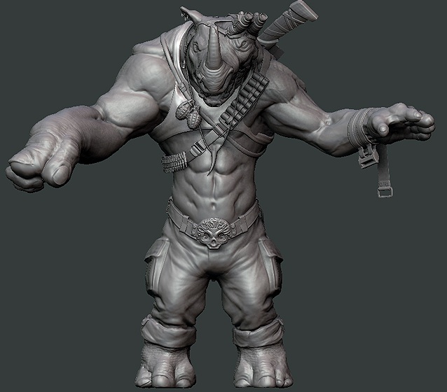

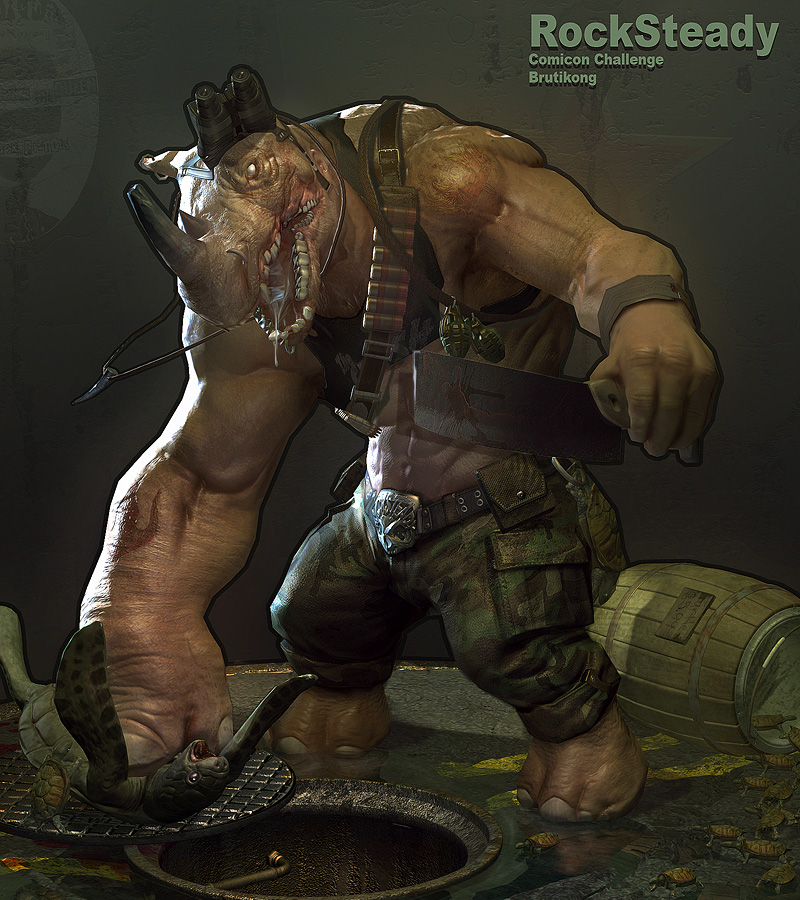

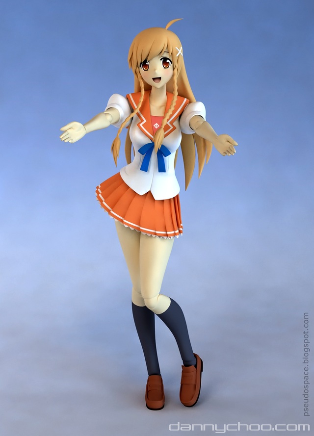

Fourth… hmm… which of the models we’re working on can I talk about…? Oh… these two are going to be two of the most challenging ones yet. I’m doing Brutikongs Rocksteady sculpt and DannyChoo.com Mirai-chan Mascot. The prints are easy. I just worry about a perfect paint. Mirai-chan I’m redoing her so her joints won’t be just fake spheres. Going to make her a perfect Figma with posable joints and vinyl skirt and everything. Let’s see how it turns out yah? Big shoutout to Ionized who is a great sculpter and super super modest.
[[attach=121247]final_sculpt2.jpg[/attach]]final_sculpt2.jpg

Awesome man! Really awesome!
Every project you do is becoming better and better!
Keep it up!
:smiley: Thanks Raf! But yah, there’s still so much more to learn and improve!
I edited the above Intervain pics cause the lighting in the conference room is an unholy shade of yellow. I read on DannyChoo.com that the best lighting to take Figure pictures in is natural sunlight (haha… also the cheapest).
Paint tut: Airbrushed a bronze basecoat. Then used black in airbrush to shade the hairline and sides of face to give it a natural look. Then used ice blue and green ink to wash the basecoat to add the patina. Then did a final drybrush of green+black do do some recessing~

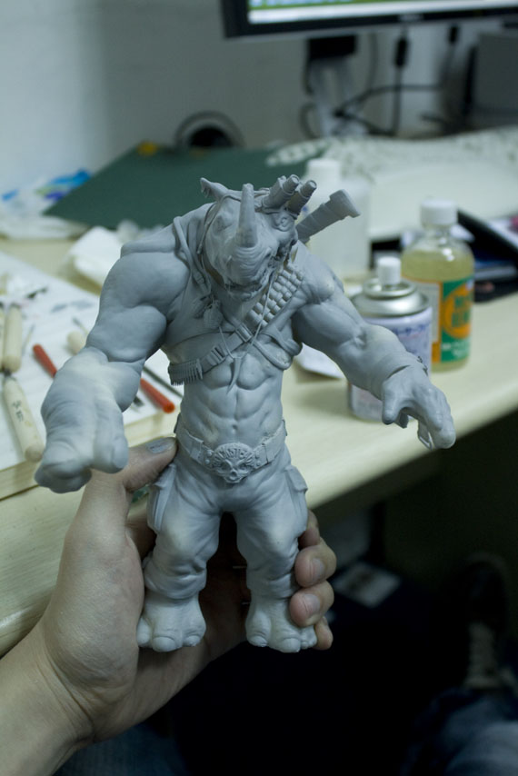

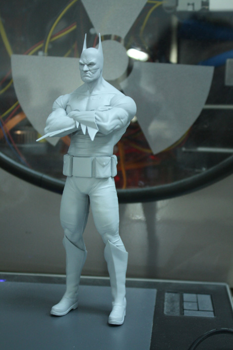

A couple unpainted prints~

love the two new pieces btw…really good quality…waiting to see more!

This is great news! I’m so glad that you are busy! That Rocksteady is exactly what I’m looking for, Desmoda!:wink: I’m with spaceboy412…tax time = more work for you!

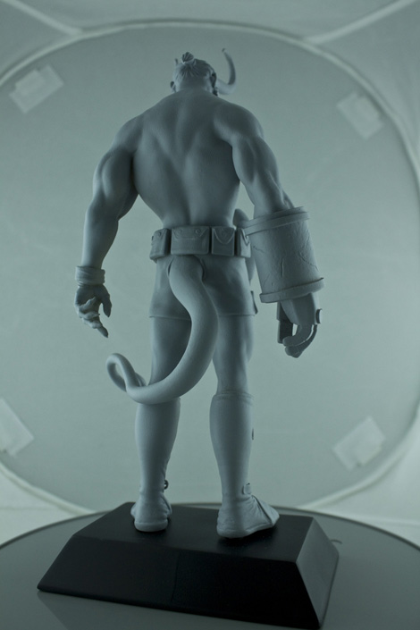

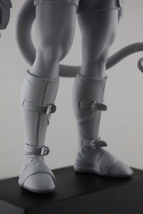

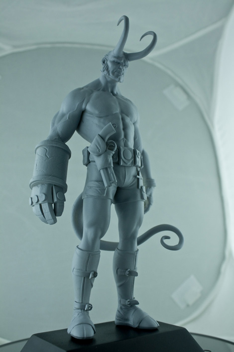

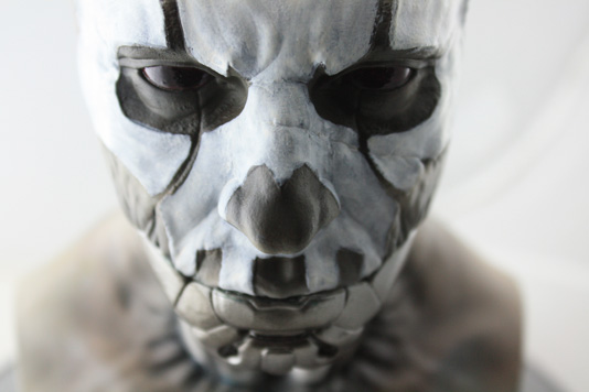

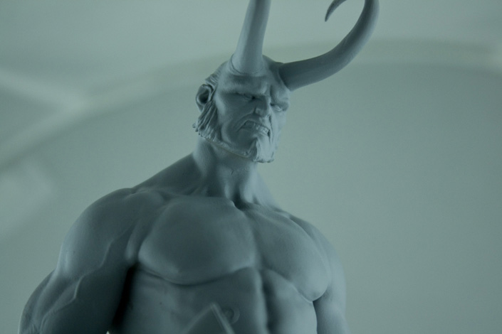

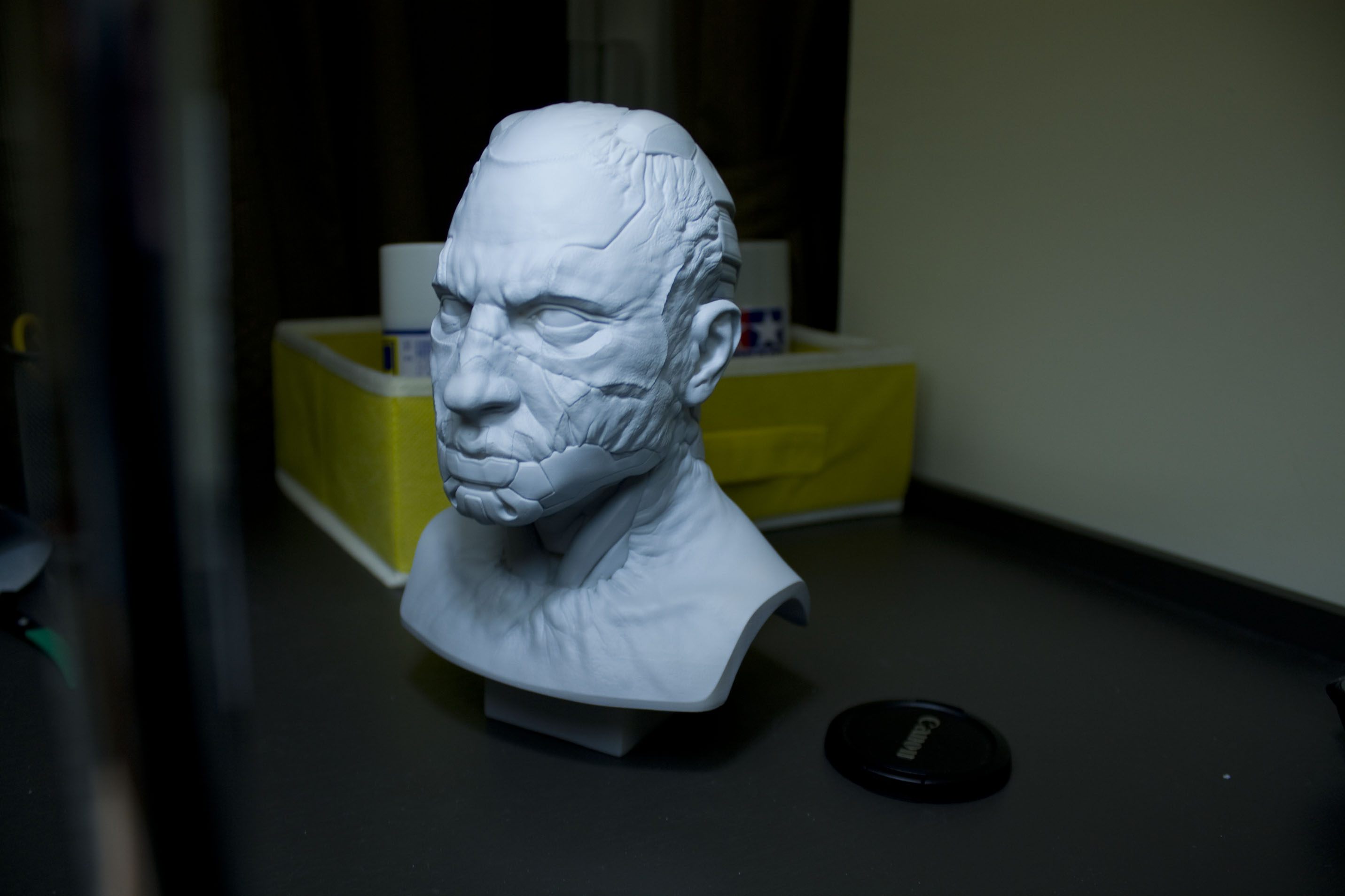

 Someone big on zbc wanted this one painted~  hopefully I'll have it done in a couple more days.  Sorry about the resolution.  I wanted to let you guys zoom up as close as possible.  I dunno why this picture came out so good?  It even has a vignette!  I put the light right next to the camera.
Wish you guys could see it in person, it even has all the pores all over the skin. I’ll try to take an underexposed photo, maybe that will help.
Reprinted hellboy~ updates soon
[[attach=128526]hellboy_akuma_pose.jpg[/attach]]hellboy_akuma_pose.jpg
[[attach=128527]hellboy_face_closeup.jpg[/attach]]hellboy_face_closeup.jpg
[[attach=128528]hellboy_front_angle.jpg[/attach]]hellboy_front_angle.jpg
[[attach=128529]hellboy_hand_doom.jpg[/attach]]hellboy_hand_doom.jpg
[[attach=128530]hellboy_laces.jpg[/attach]]hellboy_laces.jpg

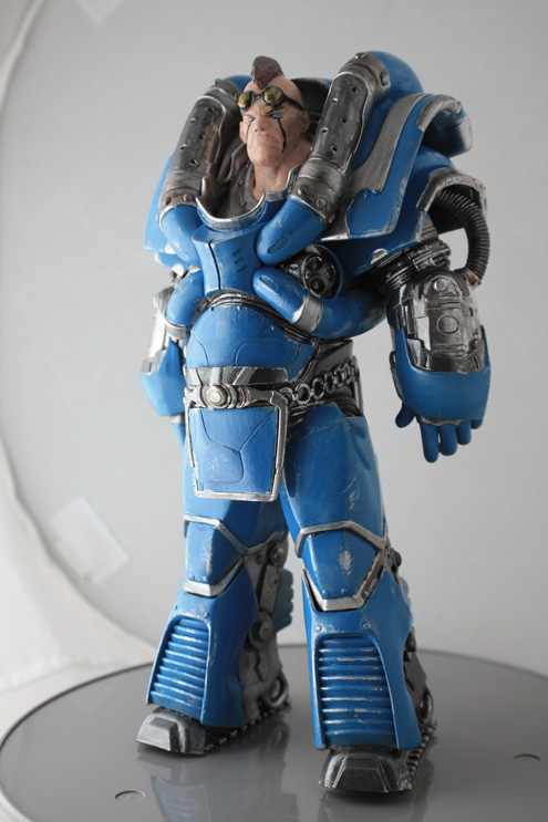

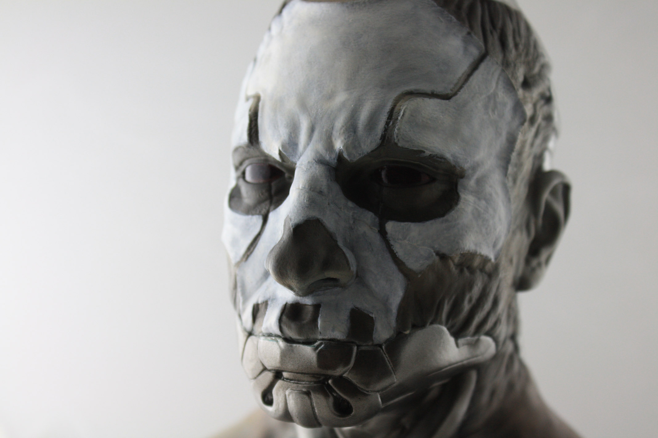

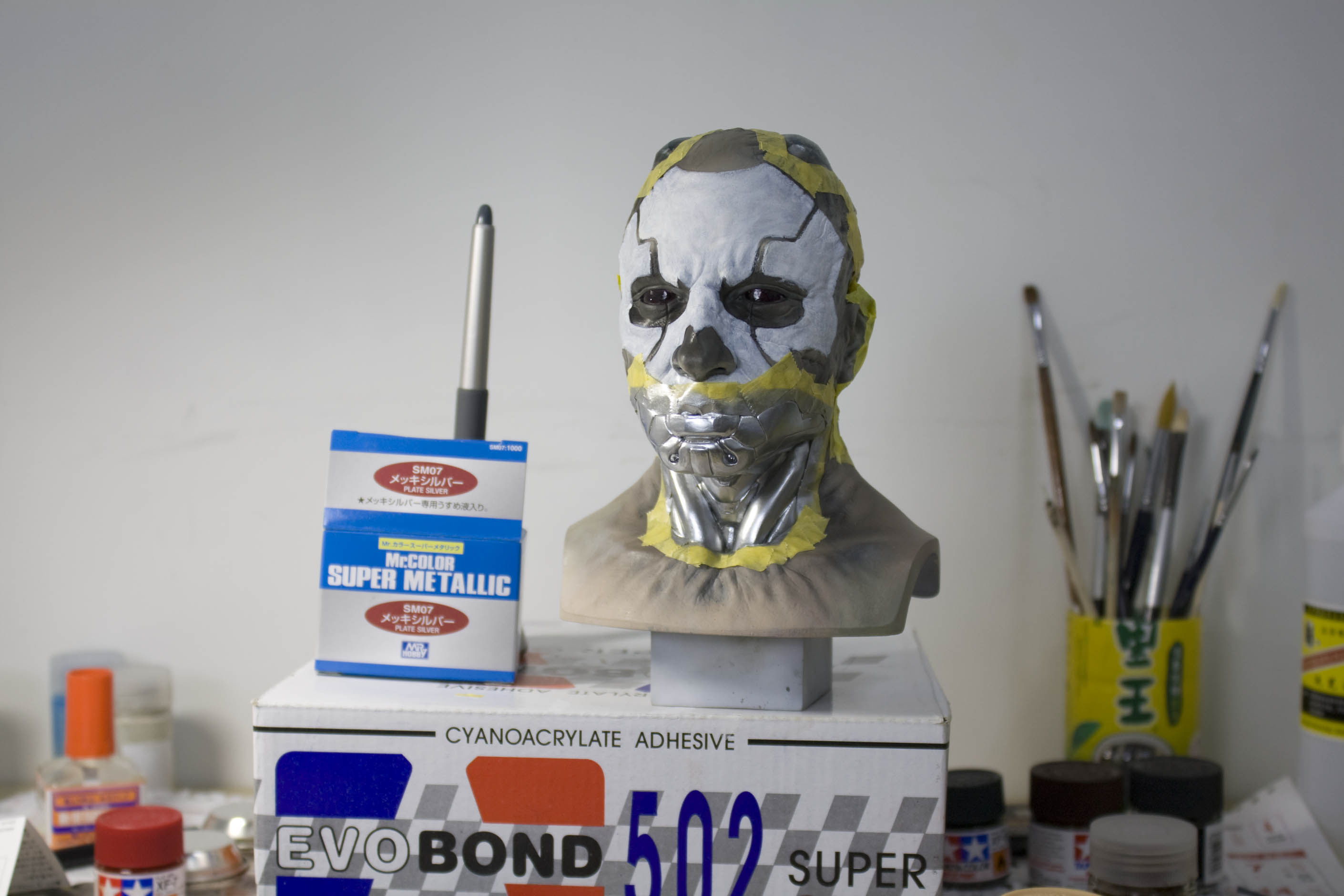

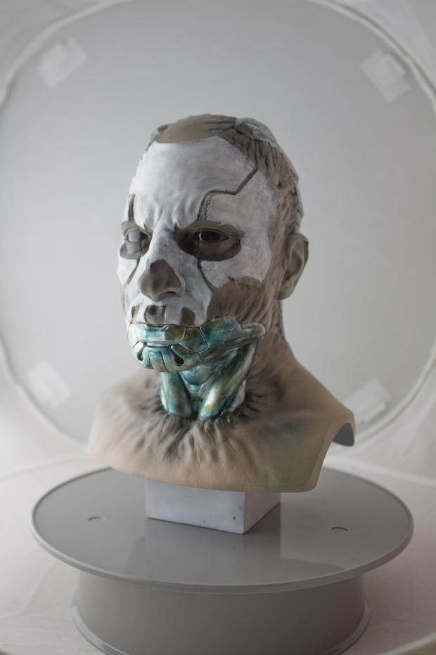

Some recent paints~ Our website is kinda borkey recently. Haven’t been working on it while we work on upping our paint quality. If you need something made, best thing is just email me at [email protected] and you can just use our ftp!
The marine was based on the starcraft limited edition model but maybe I should have gone for more of a realistic look instead of the toy look. Hellboy and Rocksteady painted coming tmr or day after tmr. I think I’m gonna repaint the chrome on the cyborg. It’s really hard to weather chrome~
[[color=#9A9A9A][attach=129297]b.jpg[/attach]](javascript:zb_insimg(‘129297’,‘b.jpg’,1,0))
[[color=#9A9A9A][attach=129298]cyborg_mojette_sm.jpg[/attach]](javascript:zb_insimg(‘129298’,‘cyborg_mojette_sm.jpg’,1,0))

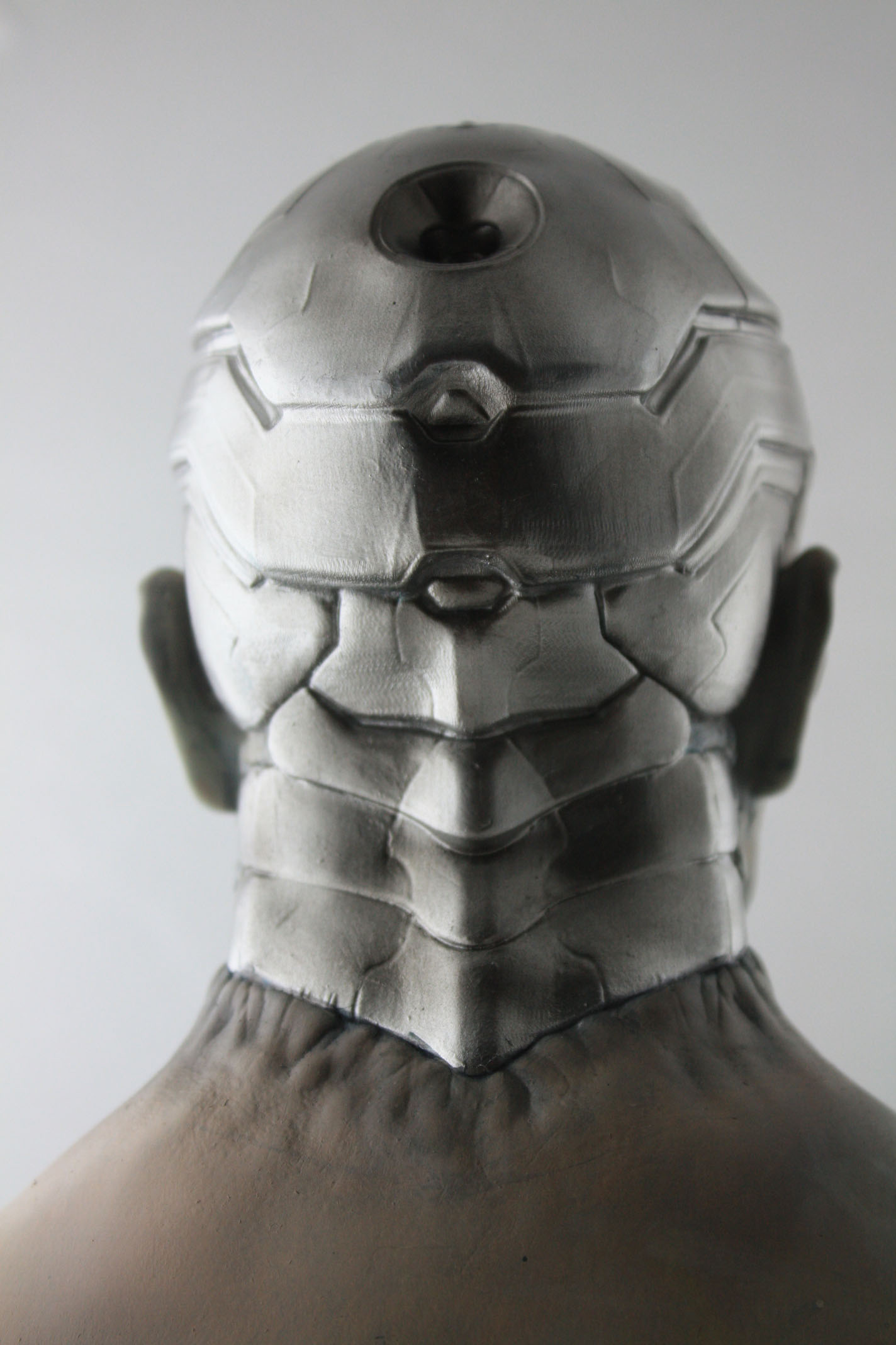

fixed the chrome. this stuff is expensive but worth it. had my airbrush set way too high (25-30 psi) so the mirror finish was getting blasted away. kinda want togo back and do the marine again with airbrush only, that would be fun :).
attached large version too.
[[color=#9A9A9A][attach=129530]cyborg_fixed_sm.jpg[/attach]](javascript:zb_insimg(‘129530’,‘cyborg_fixed_sm.jpg’,1,0))

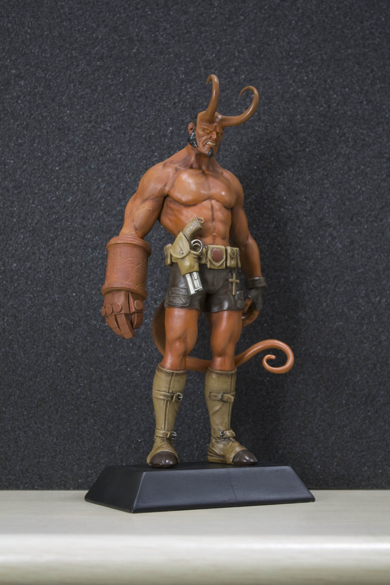

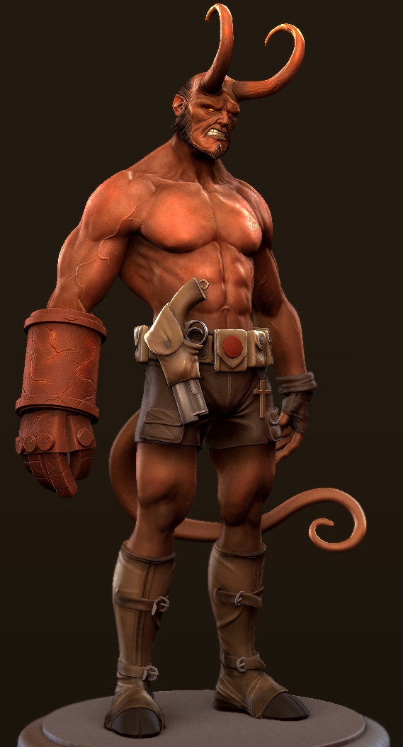

hellboy just about finished. debating on whether or not to put the glowing highlights on the hand of doom. don’t want paint to look campy.
rocksteady next! i gots 4-5 models in the works but i can’t really talk about them. otherwise the only one i can talk about is the Mirai-chan anime FIGMA figure but I’m still modelling joints in maya, gonna take awhile cause I’m doing it for myself as a surprise gift for someone i don’t know and not really as motivated. :stuck_out_tongue:
large image attached.
[[color=#9A9A9A][attach=129734]hellboy_mark2_sm.jpg[/attach]](javascript:zb_insimg(‘129734’,‘hellboy_mark2_sm.jpg’,1,0))

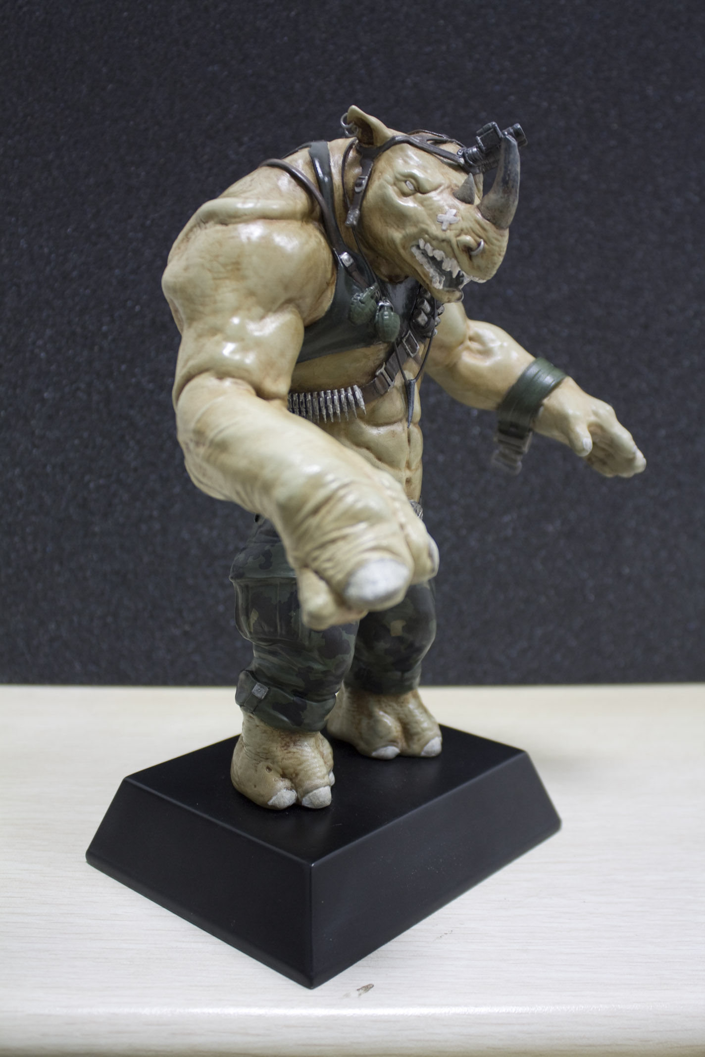

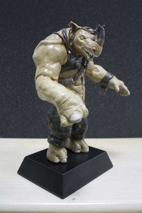

Rocksteady almost done now too. Probably gonna clean up a few things. The skin is actually a lot darker, exactly like the original render but I can’t seem to set my camera up to take the picture right. Will figure it out and replace the image in a bit. :o
Aite, probably won’t have any more model updates for 4-5 days. In the meanwhile, keep 'em coming guys~
[[attach=130467]rocksteady_sm.jpg[/attach]]rocksteady_sm.jpg
Superb…
Nice work on david character, the metal looks great…
The dino skin lookds really great too…
Thanks Sebastien :). It was fun to work on too.
Here is the final render…
[[color=#9A9A9A][attach=131060]cyborg_mojette_closeup_sm.jpg[/attach]](javascript:zb_insimg(‘131060’,‘cyborg_mojette_closeup_sm.jpg’,1,0))
that metal does look good, its also nice to see some highres pics to get an idea of the marks left by the process.
