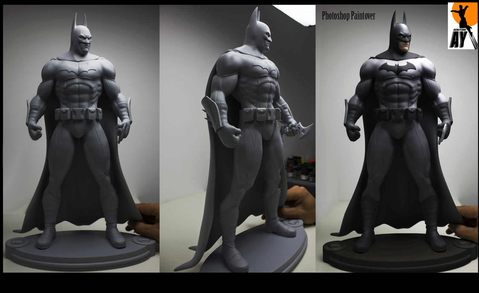

the Batman I did is public… now that its kinda released… I guess I can post a pic.
[attach=176817]batsforjorge.jpg[/attach]
[attach=176818]Batspainted1.jpg[/attach]
People talking about it here… http://www.statueforum.com/showthread.php?t=97515
haha… that photoshop paint over was what they gave me for reference… so I jazzed up the style a little when painting it~ Shout out to Avinash Hedge for the 3d sculpt. How come we never get any credit man =D?
haha those statue guys… they have no idea about rapid prototyping. If they only knew that for basically the same cost they’re paying for a retail mass produced statue… I can make some crazy crazy stuff… some of those dudes pay $1k a statue… ridiculous!.. its interesting to think what would happen if I made a little scan database on my site so people could start stocking scans or resin models for kit bashups. There would be no end to it~ Although I’m working on something better ;D

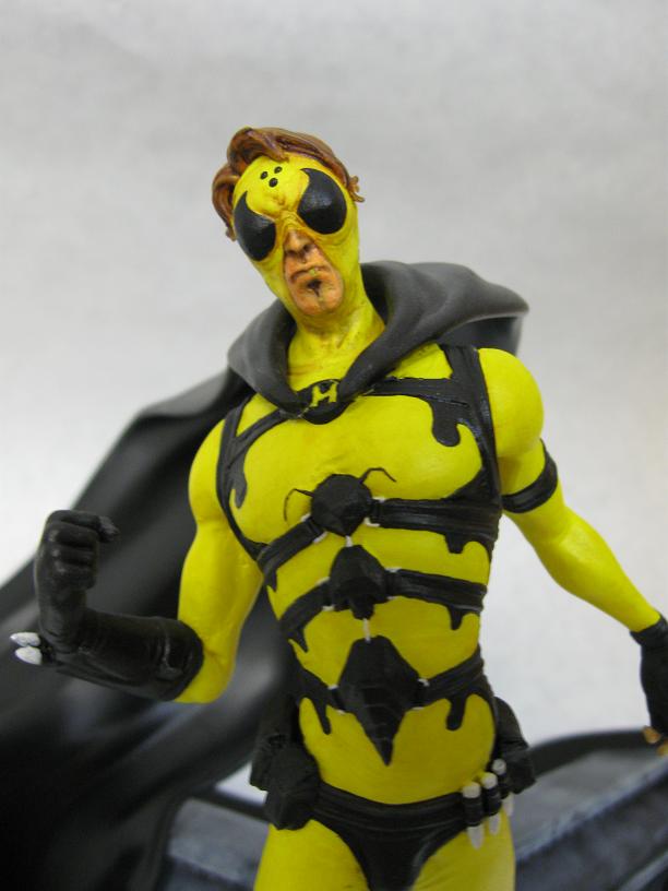

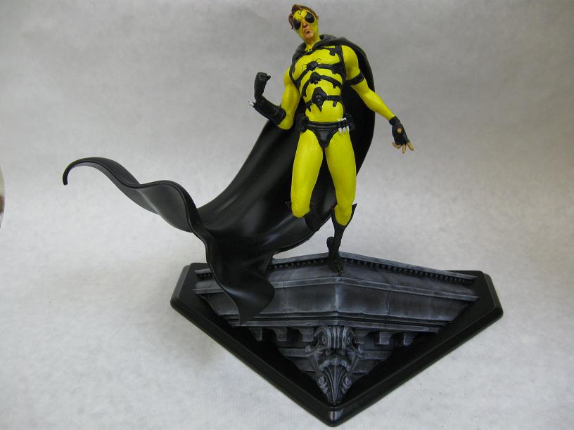

Really?! I printed and this in 12 hours and painted it in 24, awesomeness doesn’t take time. [attach=177862]comic con figs 022.JPG[/attach]
I cant see any shading/texture detail at all from the close up in your other thread. It also looks like you’ve accidently painted part of his face with the luminous yellow.
I don’t see it
