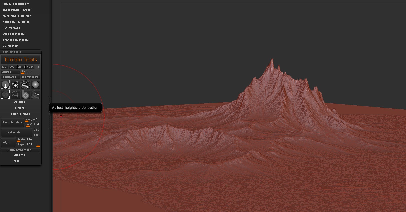

I spent hours sculpting some terrain for my graphic novel.
I would really like to work on it further.
Is there any way I can drop this model into Terrain Tools or use “Project”?
You can go back and forth from 3 D and 2.5 D but if your sculpted terrain has caves or you put a lot of effort on vertical faces or cliffs you will lose all that when you are in the 2.5 D world. To go back to 2.5 D all you have to do is Fill the canvas completely with your terrain (frame it) and uncheck Edit (or simply press T) and you are in 2.5 world. You probably knew all this…

Lay your original 3D terrain in the 2.5 D canvas and use any filters you want to use and when you are ready convert to 3D…
So now you should have your original terrain and the new edited one as separated tools, add the first to the other as a subtool so you have both in the same tool. Now you can use project and morphs and keep your original shapes in the vertical faces and caves while copying the new stuff where desired… Not ideal but possible

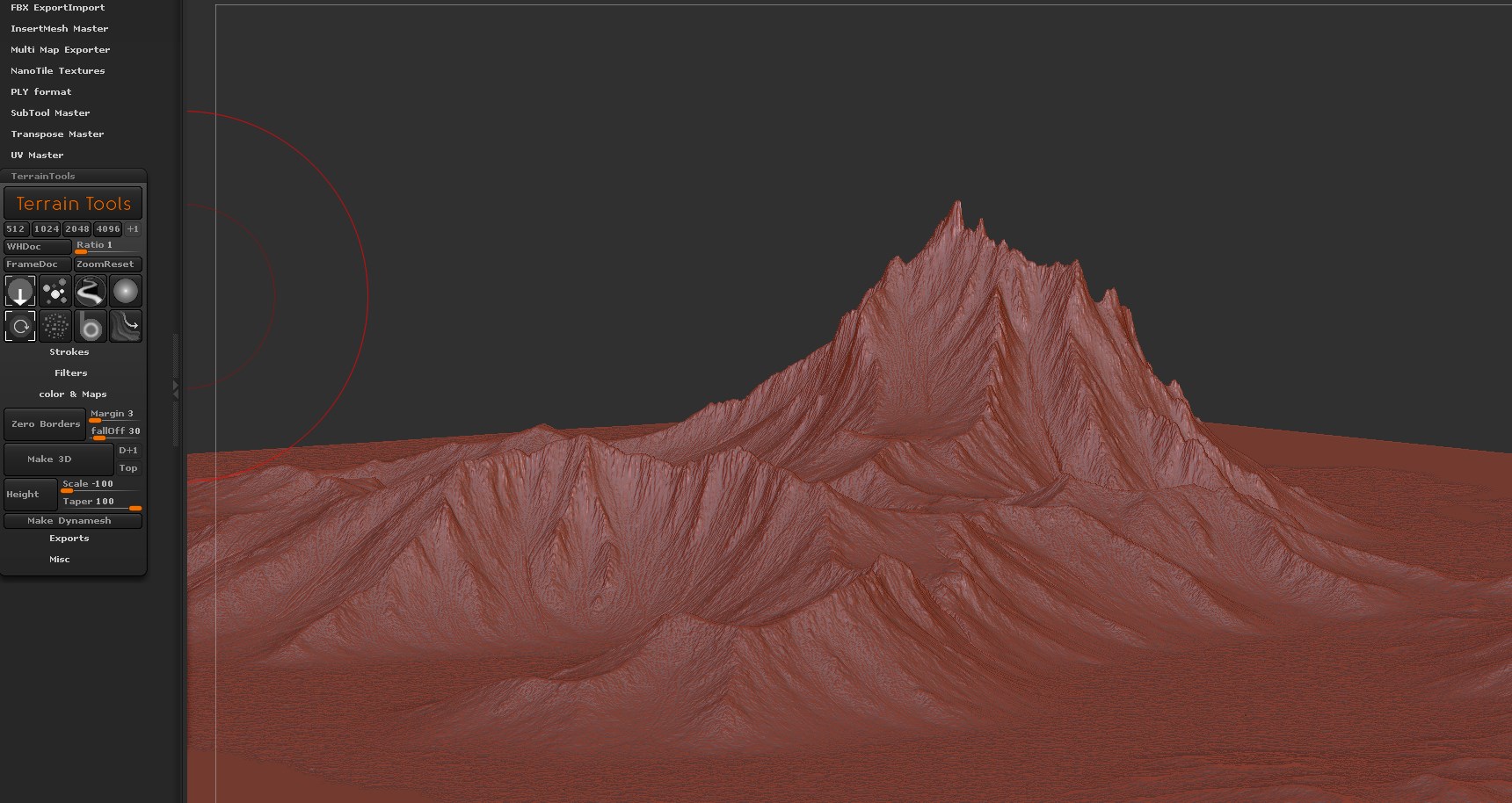

Best results so far are by following “Erosion on smooth surfaces” video tutorial. However is there any way of controlling the height that results after making 3D? I have adjusted several sliders but can’t find anything referencing to height.
Once you have a 3D model, controlling height is just a matter of using deformation:size in the y axis… I made a button under Make 3D if you downloaded the last version.

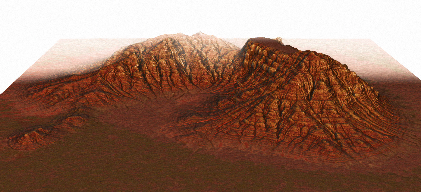

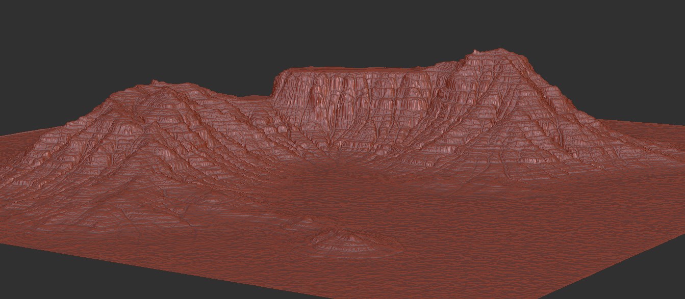

Really nice messa you have there. I would love to be able to paint a road mask and make a race track there.
Or maybe a path for the camels to travel on The Silk Road.
Tanks drargelos, of course resize using deformation. It does work best using "Erosion on smooth surfaces " video you provided. I am currently trying to export my current sculpt as alpha to be imported into Unreal Engine, Just trying to find the best workflow…
Roctavian, yes, I miss the roads too… As I mentioned before, I made a little script that can be used to make roads I might include it as it is…
I am not really going to do anything with his terrain If you want to use it… I was going to make a path to the top of that mesa and put some ruins or a fortress there…

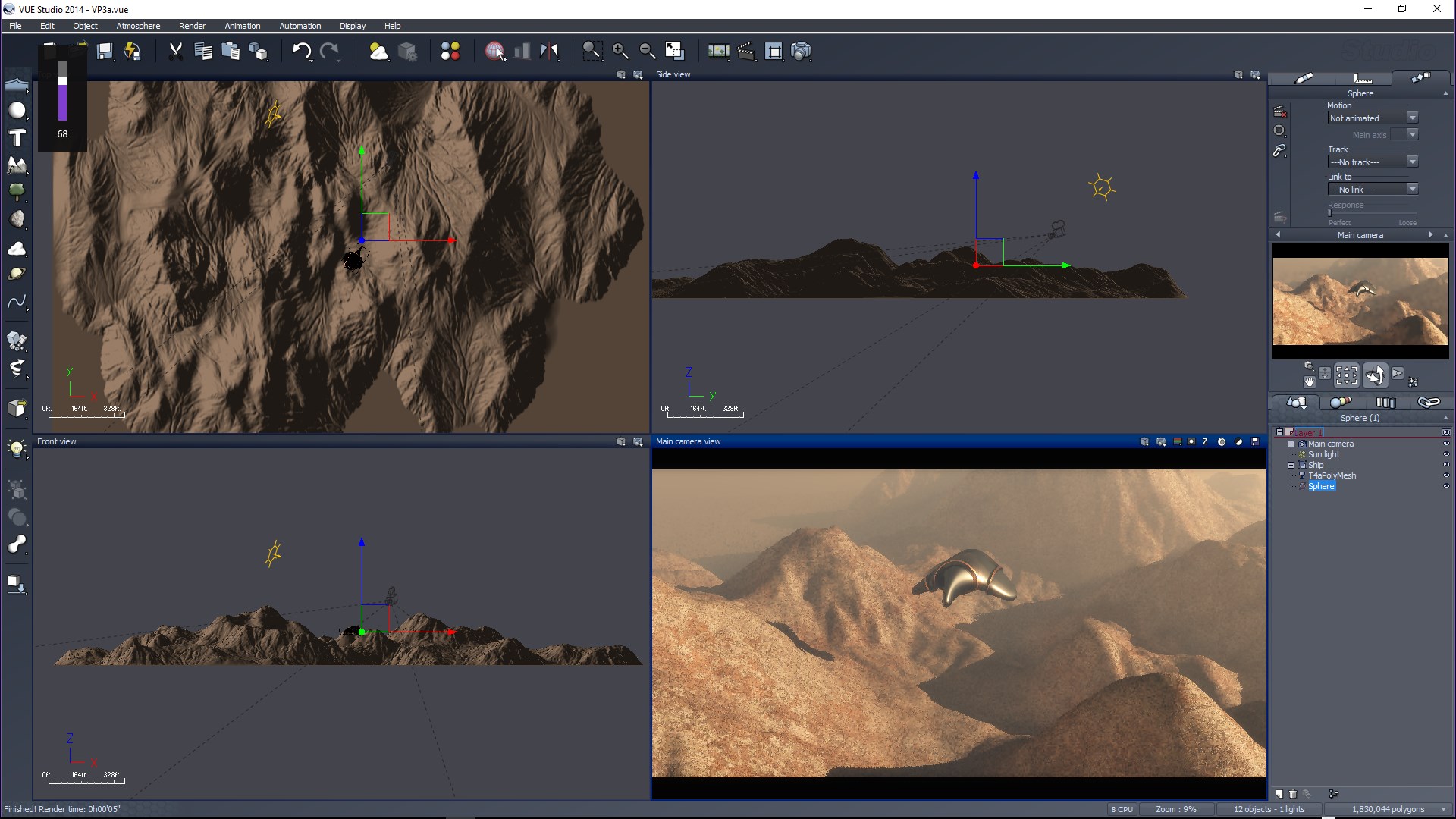

but have been having fun exporting terrain to VUE.
BTW, I found that if I “Make 3D” and export as an OBJ, e.g. in this case (see screenshot) the mesh is 93mb, but
if I “Create Polymesh”, then export, it drops to 54mb (?)…a very good thing. Is that your workflow, too?
My first try…ZShip in ZTerrain.

I never actually tried that with VUE. What I did was importing the PSD directly to the “terrain generator” in VUE…Not sure what would be faster to be honest but another thing you could try is decimate the mesh and add planar (if you do that in sb you have to rotate the terrain so it’s perpendicular to the ground, then apply planar UV ,and rotate again… )

And thanks a lot for posting the pictures . I loved it …
I used the Import function in VUE…not sure what is the best way so far, but will try PSD, too.
The scene is “Vista Peeps” in the sample scenes, and I sized the ZTerrain to approximately the size
of the sample terrain.
Some VUE materials work great, and others crazy bad. Some are based on image textures and some
are procedural. I’m just experimenting to see what looks decent, and keep the details in the terrain.
