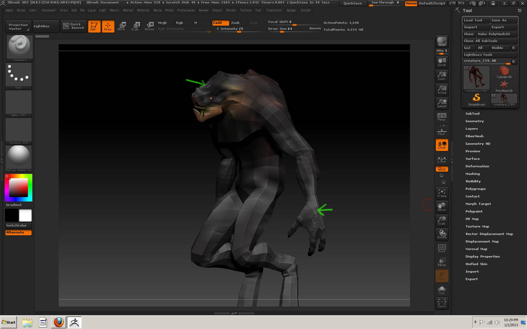

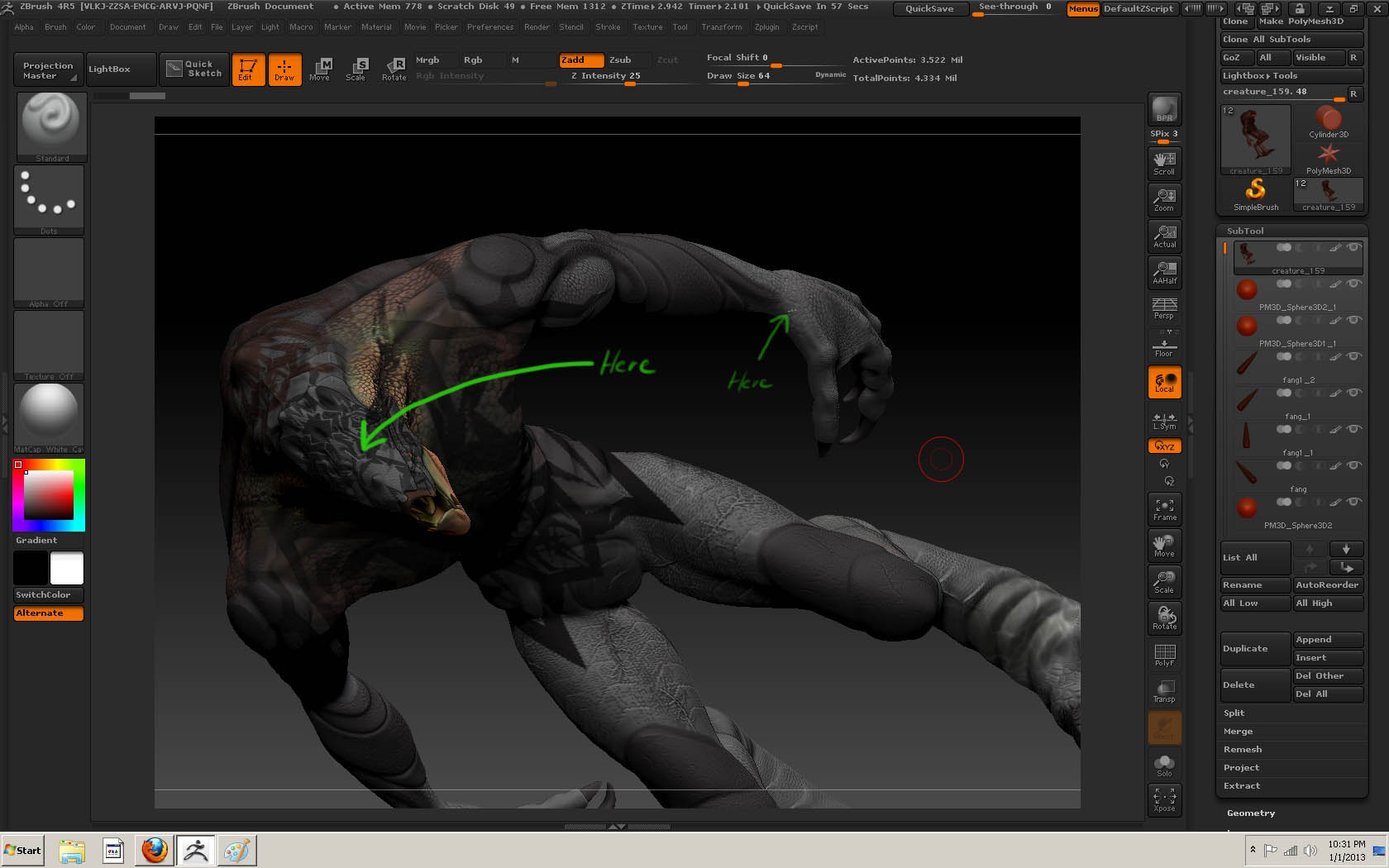

Hi all, I upgraded to 4R5 last week and I started using it today and noticed a weird display problem. These white “lines”, that appear to be geometry, just happen to be displaying on my model, even when I rotate it. They will somehow remain fixed, but move to another part of the model. Please see images. I checked my textures and polypaint menus, and there is nothing that indicates it’s a texture problem. I restarted the program, and the glitch remains. Has anyone else experienced this issue with the new upgrade? I’m really hoping a patch is released soon.

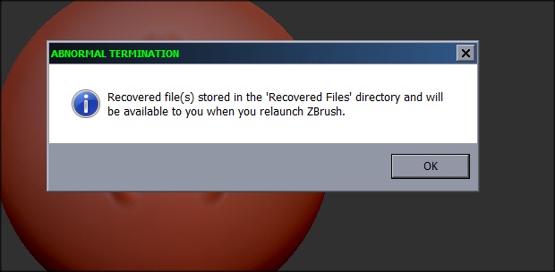

I get this every time after I have Undo (Ctrl+Z) a couple of times then go to subdivide the mesh. Answer OK to error and it crashes to desktop. I hope this gets fixed in the next update.
Just did it twice in a row, once with sphere and once with cylinder. Same error.

JD. I had the same thing. If I’m not mistaken, those are simply incomplete curves, I dragged mine out of the main mesh using one of the curve brushes, then deleted the generated geometry.

Having said that and with reference to the other display issues mentioned, whilst I get the disappearing mesh issue like everyone else, I no longer get the weird corrupt lines issues when I rotate my mesh!
